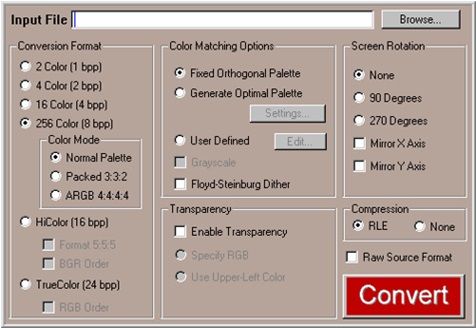

i do not know how these bitmap arrays were derived, but i think PegImageConvert tool may
have been used (Pls see the screenshot below).
If using this tool might be necessary, i would like to get access to this, as this is currently missing.
 PEG Image ConvertPEG Image Convert
