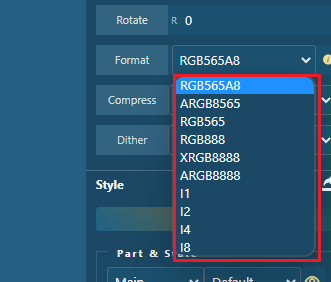

GUI Guider only offers two image format options, both of which occupy a large amount of space. Some of my images are only two-color and require smaller format options, such as the variety of image formats provided in the link   https://lvgl.io/tools/imageconverter.

Hi @ZackLin
Please Use the V9 project.
If this doesn't meet your needs, you can only manually add it to the code.

Will guiGuider support more image formats in the future? The current formats are too limited, which is not ideal for small-capacity devices. For example, could support for the "CF_INDEXED_2_BIT" format be added?

I'm using the v8 version of the project.
