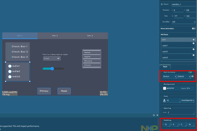

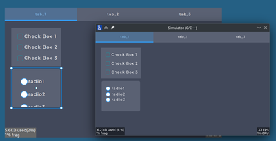

I wanted to put padding in between the radio button elements but it didn't do anything, by looking at the code it seems that
lv_obj_t * lv_radiobtn_add_item(lv_obj_t * parent, const char * txt)
  lv_obj_set_style_pad_all(obj, 3, LV_PART_MAIN);
at lvgl/src/extra/widgets/radiobtn/lv_radiobtn.c:96 is at fault, it is overriding the generated style:
lv_style_set_pad_left(&style_screen_radiobtn_1_extra_btns_main_default, 15);
lv_style_set_pad_right(&style_screen_radiobtn_1_extra_btns_main_default, 9);
lv_style_set_pad_top(&style_screen_radiobtn_1_extra_btns_main_default, 12);
lv_style_set_pad_bottom(&style_screen_radiobtn_1_extra_btns_main_default, 10);
lv_obj_add_style(screen_radiobtn_1_item, &style_screen_radiobtn_1_extra_btns_main_default, LV_PART_MAIN|LV_STATE_DEFAULT);

Hi @FederAndInk ,
Thanks for your feedback.
You are right with this issue and we will fix it in next release (V1.6.0).
Please feel free to give any type of feedback (bug, improvement, feature and etc.) in the community to help us make GUI Guider better.

FederAndInk
You can see in my first post the difference between what GUI Guider shows and the application running (I put high padding values to better see the difference):

FederAndInk
What do you mean? we can do that with plain lvgl, also in GUI Guider there is a Padding section for it and the preview is updating when you change the padding, but running the application isn't reflecting the changes
