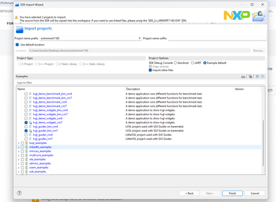

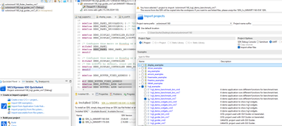

I am trying to evaluate LVGL v9.2.1 performance and compare with LVGL 8.3.10 to see VGLite improvements if any.
I am uisng MIMXRT1166-EVK Board and 25.06.00 SDK. I am importing both lvgl_demo_widgets_cm7 example for OS and for Bare metal.
** Baremetal example runs properly, however VGLite is not active in baremetal. That is why I have to use the example with FreeRtos one. However, after compiling and deploying the code to board, it displays nothing. I compared both mcux_config.h files. Both nearly the same config but FreeRtos example not works? Waiting your helps..

I've tested the lvgl_demo_widgets_cm7 example code from the SDK v25.06.00 on the RT1160-EVK board and was able to replicate the issue. Although the application seems to be running properly when debugging, the screen doesn't show anything and remains black.
I will report this issue with the SDK team so they can provide a fix on a future release of the SDK. I will come back if they provide me with a workaround or fix for this version of the example code.
