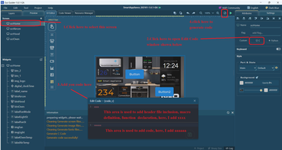

This is AE reply:
You have two application scenarios to add your custom code in GUI Guider.
    1. For example, there is a screen named scrHome in you design. You want to add some initialization code when this screen is initialized. You can do it like this
then you reopen or update your project, you can see the new code are all added to the project like this:
2. For example, you have a button and you hope when this button is clicked, you can execute your custom code. You can do it like this:
1.Place a button in the editor
2.Add a clicked event
3. Add your code with method described in scenario 1, your code will be added into the event handler
4. If your code in event handler has a function call, you can implement it in custom.c located in the custom folder, certainly, you can create your own file and placed into custom folder.
However, the current version, 1.6.1, GUI Guider doesn't support subfolder. Subfolder will be supported in 1.7.1.
Hope it can help you
XiangJun Rong
