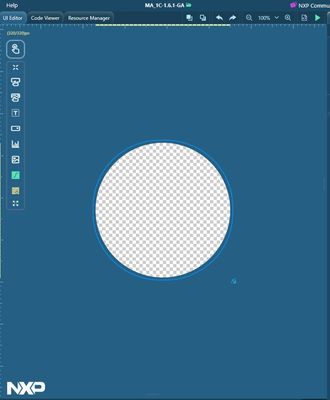

Testing the PC simulator I noticed that in GUI-Guider v1.6.1 the first screen displayed is the one that was open when compiling the project, while in previous versions it was the screen at the top of the list. Is there a way to set a screen as "home" screen despite its placement or being current when generating the project?
Also, it seems like the platform radius is not saved with the project (I'm playing with a project that was converted from a previous version), I didn't try creating a new project to see if it has the same issue.

1) I didn't find the home screen behavior in the documentation, could you please point me there?
2) Regarding the platform radius, see the pictures explaining what I mean.
 Platform radius on openingPlatform radius on opening
This is what appears when opening the project.
Platform radius I needPlatform radius I need
This is after I modified the radius to have it square. Saving the project and reopening the project the circle radius is set again.

1) For Home Screen, please refer to the picture below:
2) Regarding the platform radius problem you mentioned, we will submit it to the GUI Guider development department .

1)Thanks for your sharing,  the Home screen you said is being optimized and upgraded, please pay attention to the official website at any time. 2)And as for the platform radius you mentioned, in order to better help you, please share your project or screenshots so that we can replicate your question?
