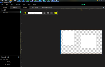

Gui Guider 1.9.0-GA with LVGL v9.2.1,

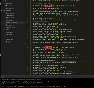

if define two canvases, then build error
lvgl-simulator/../generated/setup_scr_screen.c:30:24: note: previous definition of 'draw_buf' was here 30 | LV_DRAW_BUF_DEFINE(draw_buf, 132, 165, LV_COLOR_FORMAT_NATIVE);

Hi @greyorbit
Thanks for your information.
I will report this issue to the GUI GUIDER IDE team and we will resolve it as soon as possible.
