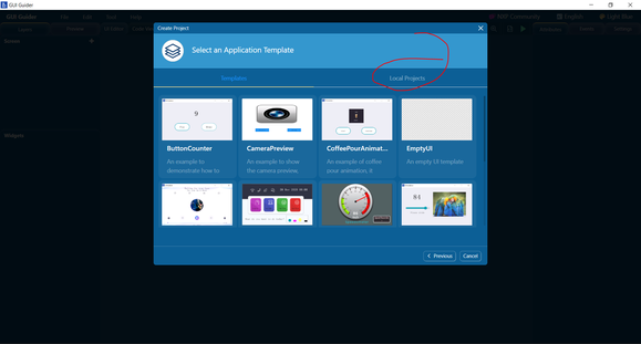

I have a bug creating a V8.3.2 LVGL project.
Using any board template, then in the "Select application template" I try to use a custom one I did before, and when clicking on "Local Projects" all screen turns white having to close the application.

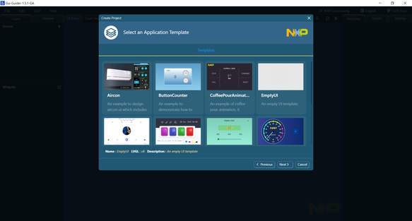

daniJVV
I downloaded the new version, GUI Guider 1.5.1, and there is no "Local projects" option, so there is no problem anymore.
Version 1.5.0:
Version 1.5.1:
