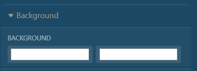

11,154 Views
zhenhualuo
The background color can be configured in GUI Guider, you will see the background setting when a widget is selected in the UI editor.
