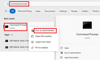

both the installer and the register.bat use the "regsvr32.exe" system utility, which shall be installed by default in any Windows operating system.
First, make sure the regsvr32 utility exists on your system. Just press Win+R and Run the command "regsvr32".
You should see the a help box like this one:
If this utility does not work, your computer might have a system restriction applied by your administrator. You will need to get it fixed.
If the regsvr32 works normally, let's see what errors the register.bat prints:
  1. Open the start menu.
  2. Locate the "Command Prompt" application
  3. Right-click and select "Run as administrator" (see picture below)
  4. In the console, type cd "c:\NXP\FreeMASTER 3.2\FreeMASTER"
  5. Run register.bat
  6. You should see no errors (like in the picture at the end).
  7. If no errors, the plug-ins shall appear in FreeMASTER. If there are any errors, please share it here.
Michal
