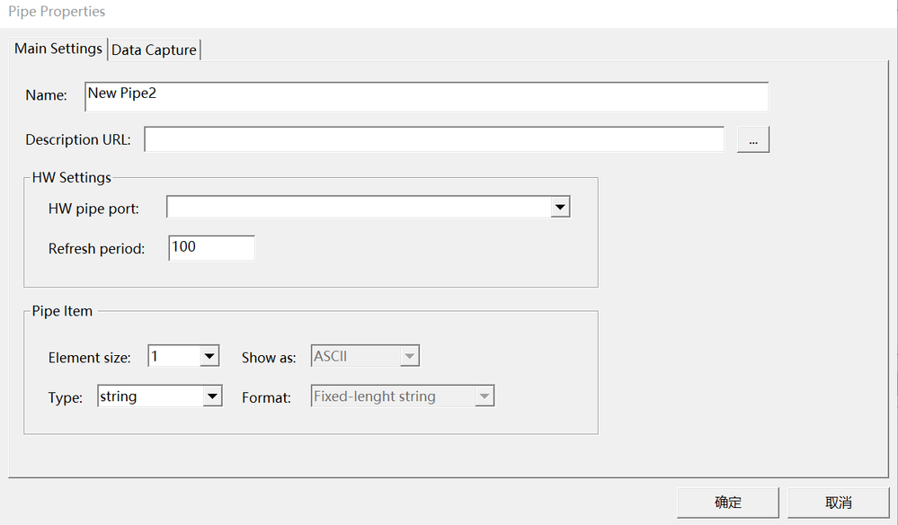

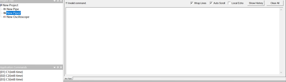

Hello , I have a mistake of pipe function.
My code configure:
I use BDM communication with KEAxx api and other tools like 'recorder' are correctly working.

Dear Charl,
please use a non-zero pipe "port" identifier when calling FMSTR_PipeOpen. Use a number in range 1..127. This should help.
Michal

623619261
Thanks!
I'm sorry for my late reply.
It works!
