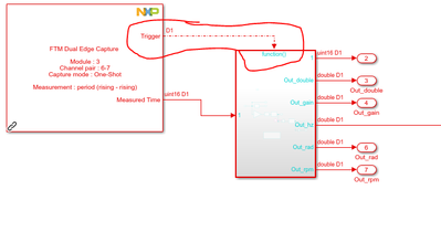

1. First of all, it appears that the block for the Edge Capture interrupt is not triggered as shown below.
mariuslucianand_0-1675704362317.pngmariuslucianand_0-1675704362317.png'
The way you have used it implies that the code inside the subsystem is executed on the main step of the model when it actually needs to be executed when the input Edge shall trigger the interrupt. In the below construction, the Simulink function inside the block will be executed when the rising-rising signal is triggered. The same is with the Dual Edge Capture Restart block. This shall be used inside the s-function triggered block to reset the input edge counter after triggered, otherwise, it will be triggered each step execution.

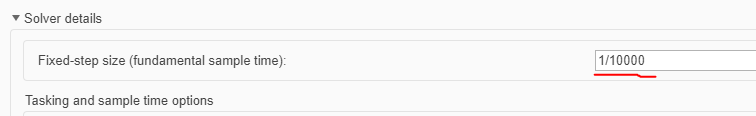

2. The second thing you have to take into account is the step frequency, related to what it needs to do. For example, in your model, the step frequency is 10kHz. I've noticed that the step mainly computes the new PWM duty cycle. But, the frequency of the PWM block is 5kHz. Basically, it tries to compute/update the duty cycle twice faster than a PWM period so you might try to adjust the model timing.
