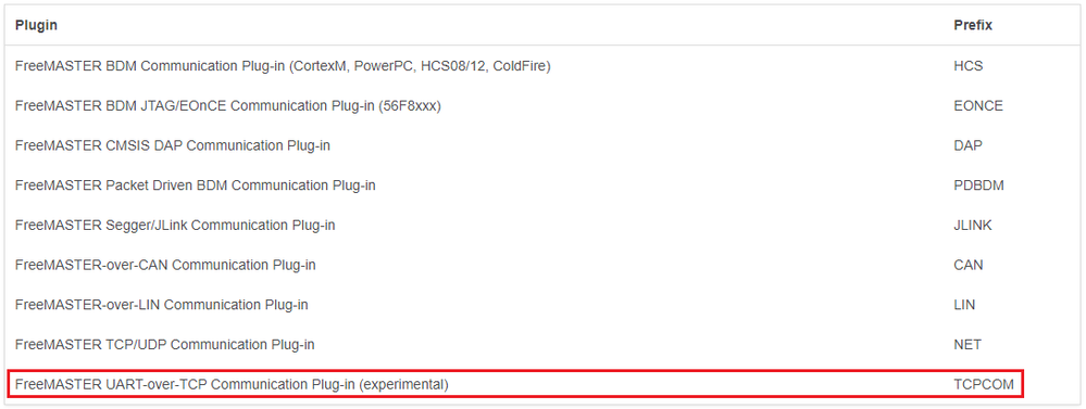

iulian_stan
Hi @AELhammoudi,
Are you referring to Serial over TCP communication plugin ?
If so, it is supported by FreeMASTER Lite but has experimental status:
I just noticed that the connection string generated by the FreeMASTER tool when exporting service configuration has a wrong format (we will address this issue).
Could you check if your connection string is using the following format:
TCPCOM;{HOST_NAME};port={PORT_NUMBER};timeout={TIMEOUT_IN_MS}
example:
  "connections": [
      "name": "preset",
      "description": "Default connection",
      "connection_string": "TCPCOM;127.0.0.1;port=5001;timeout=2000"
 Let us know if you are still facing issues using this feature so we can improve its stability.

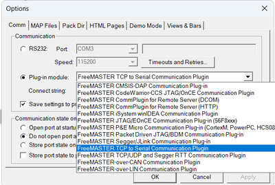

AELhammoudi
Hi @iulian_stan ,
Thank you for your response!
I'm referring to this one, are they identical?
kind regards,
Adnan

iulian_stan
Hi Adnan,
Yes, that's the one I was referring to.
