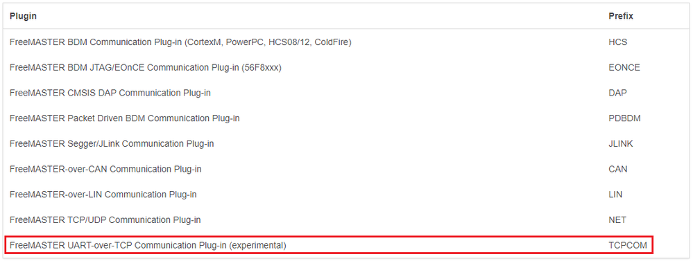

I have an application using a TCP over serial plugin, and it seems to be connecting to the desktop application.
Now, I need to implement some pytest cases with integration of FreeMASTER Lite. After multiple tries, I found that it was not possible to connect via this plug-in, and  I found it's not supported yet.
Do you have any suggestions or feedback? thanks!

Are you referring to Serial over TCP communication plugin ?
If so, it is supported by FreeMASTER Lite but has experimental status:
I just noticed that the connection string generated by the FreeMASTER tool when exporting service configuration has a wrong format (we will address this issue).
Could you check if your connection string is using the following format:
TCPCOM;{HOST_NAME};port={PORT_NUMBER};timeout={TIMEOUT_IN_MS}

AELhammoudi
Hi @iulian_stan ,
Thank you for your response!
I'm referring to this one, are they identical?

iulian_stan
Hi Adnan,
Yes, that's the one I was referring to.
