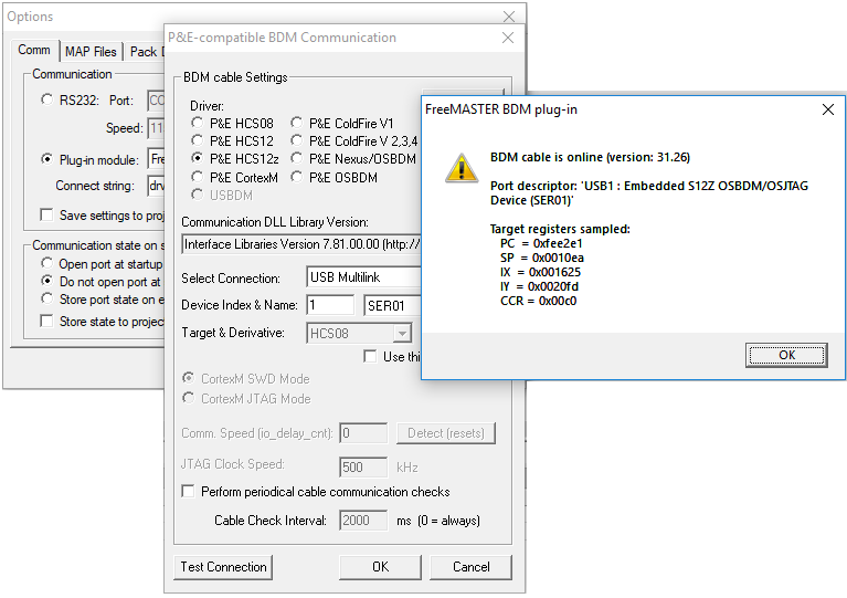

All resisters are seems 0x0 on FreeMASTER's Variables Watch like attached picture.
Perhaps I guess debugger's clock issue because I am using DEVKIT-ZVL128 on 32MHz Bus Clock.
And I know a function Uncheck “Use Bus Clock as Debug Controller(SIBDC) Clock Source {default=Checked}”in CodeWarrior, for ecample.
Could you tell me, How can I do in this case of FreeMASTER?

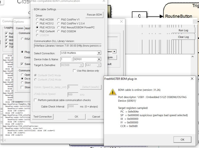

I have the same issue. See below screenshot of test connection.

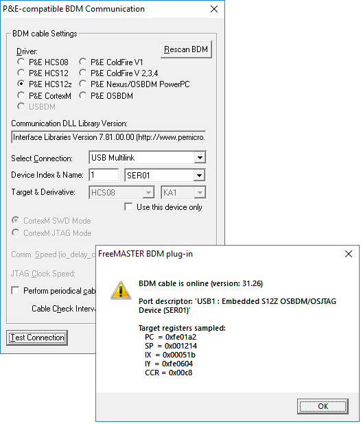

I have tried to replicate the issue on my side with DEVKIT-ZVL128 board and it runs properly both with the on-board OSDBM (SER01) as well as with an externally connected P&E Multilink device.
It is possible that in my case, I have a different clock setup in the application startup code. Can you please share some minimal test application with me here (e.g. just a single variable incrementing) to try exactly what you have?
My firmware version reported by the cable is the same as yours (31.26), but still I would recommend to download and install the latest OSBDM Firmware Updater from www.pemicro.com/osbdm (use the first link named Firmware Updates & Recovery). After installing the package, run the PEFirmwareConfig.exe and update the on-board firmware. You will need to short the J17 during update. Use the CodeWarrior then to download your application again at least once using the OSBDM debug port.
Michal
FYI: This is my screenshot.

Hello Michal,
Thank you for looking into this subject. I have uploaded a demo project https://community.nxp.com/docs/DOC-347023 .
Hope you can find the issue. (I did not yet update the firmware).

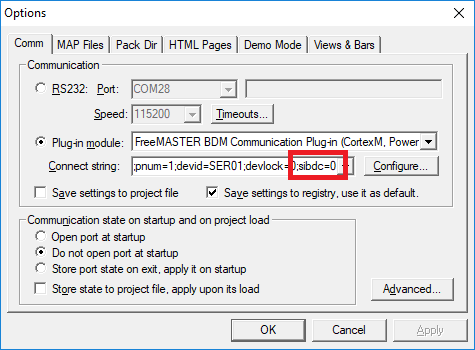

I have got some instructions from P&E on how to enable the same feature like CodeWarrior's SIBDC checkbox in the debugger settings. I did a test build of the FreeMASTER BDM plug-in for your testing. I'm attaching it here, please extract the bdmpgi.dll (version 3.27.0.0) over the one in your FreeMASTER installation "c:\NXP\FreeMASTER 3.0\FreeMASTER\plugins\bdm\bdmpgi.dll".
There is no GUI button to turn the SIBDC bit low in this prototype yet. For testing, just add ;sibdc=0 to the plug-in's connection string. After adding it, press the Configure button and try to "Test Connection". Your DEVKIT-S12ZVL application should be detected successfully. Note that if you omit the sibdc parameter in the connect string, the default behavior is the same as if this parameter is set to 1 - just like in the CodeWarrior.
Please let me know if this helps in your case. I will add some GUI checkbox to control this settings in the next release.

Sorry for my late reply but it works indeed. Thank you!
