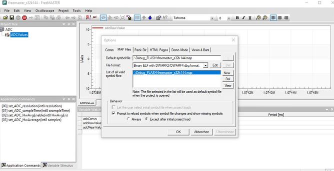

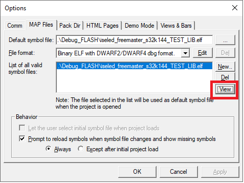

FreeMASTER needs to know the addresses of the C symbols used by variable definitions. The message you are getting means that FreeMASTER does not know what is the "adcConvs".
There are two ways to give this data to FreeMASTER:
  • Specify the ELF file in Project settings ("MAP Files" tab)
  • Provide the data in runtime using so-called "TSA" feature.
I recommend you to use the first option now and make sure to press the "View" button in the Project Options to display all symbols the FreeMASTER is able to parse from the ELF file. If "adcConvs" is not there, probably this variable is not defined in the application, or it is never used and optimized-out by  a compiler.

Please use the binary ELF file (the linker output) in place of the MAP file. FreeMASTER is able to parse the symbol tables and the debugging information inside the ELF to get symbol addresses.
Note that the ELF file may have a different extension (.out, .axf, .elf) depending on the compiler. I'm not sure what the DS32 uses.

frankmuenzner7421
Thank you very much - i had read it before, but did'nt remember    - in my logical thinking map file is map file and not .elf, many thanks i wouldnt find out with your help

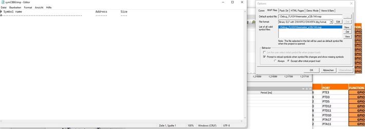

frankmuenzner7421
Thanks for your fast answer, if i looked at your sreenshot of my projects - the wrong mapfile is used - i see it before you answered me.
My actual settings look like this: Overview FreeMaster setting_Options _Map Freemaster.jpg
So it seems thart no symbols are recognised - must i activate some compiler switches in S32 Studio?
Many thanks for your time and help
