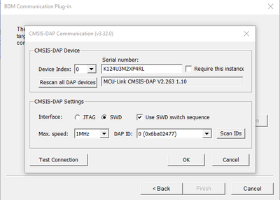

can you tell more about your connection from the PC to the target and if you use the TSA feature?
If using serial line, CAN, or USB, the freemaster accesses the core which implements the communication (CM7 in this case I guess). So the CM4  variable visibility and addresses depend on how the CM7 sees them in its address space. Normally, the CM7 should be able to see the OCRAM space of CM4 (0x20200000).
Be aware that if you use the TSA feature and TSA_SAFETY feature (enabled in freemaster_cfg.h), the access to "unknown" variables can be actively blocked by freemaster driver unless you put them all to any TSA table. You can experimentally disable the TSA and only use addresses loaded from the ELF file.
In case of using JTAG direct memory access (CMSIS-DAP etc.), all memories should be accessible, unless the JTAG is disabled.

I'm using MCU-Link pro (SWD) as the connection to the board. The TSA is disabled.

OK. When using SWD, the TSA does not matter. The FreeMASTER accesses the memory directly over DAP MEM-AP. Can you describe what addresses are not accessible? What memory is used as RAM by your CM4 project?
What values does the FreeMASTER show for the variables which do not work? Does it show zeros or question-marks?
In my case, the CM4 OCRAM (0x20200000) can be accessed in FreeMASTER over CMSIS-DAP well - I have created a FreeMASTER variable at this address and it can be both read and written.
