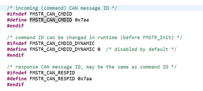

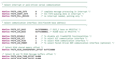

I've configured all the settings in freemaster_cfg.h (I've referenced freemaster driver example)
 and I've checked that I am using MCAN0 channel.
I've also checked FMSTR_CAN_CMDID and FMSTR_CAN_RESPID which was set default as 0x7aa.

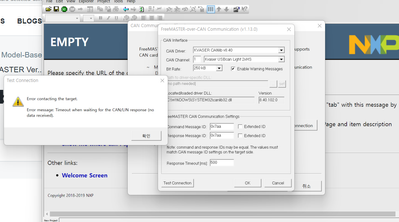

When I try to Test connection, the error message pops up.

Hi @InhyeokHwang,
Could you compare your CAN configuration with the one from demo project from "C:\NXP\S32DS_Power_v2.1\S32DS\software\FreeMASTER_Serial_Communication_Driver_V2_0\examples\SCI_driver_examples\MPC57xx\MPC577xC_EVB_e200z7_Core0\src\periphinit.c".
There was an issue reported on another platform caused by SDK misconfiguration. You can find an example here.
