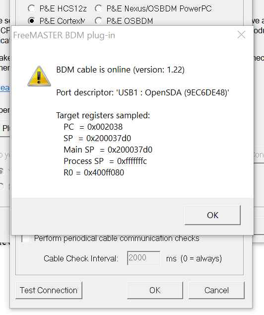

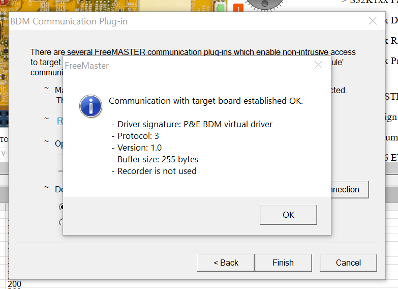

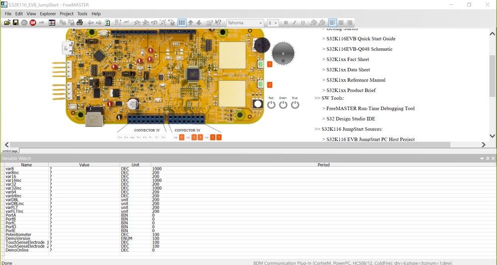

Although we are able to connect to the S32K116 using the FreeMASTER tool(same issue with 2.0, 2.5 and 3.0 versions), we don't see the variables watch being updated. There is a "?" in front of all the variables and we are not able to control the LEDs, the pins or interact with the Eval Board in any way. But we can see the RGB LED constantly switching colors.
The below screenshot show the succesful connection with the Eval Board:

can you make sure you have a correct ELF file specified in the FreeMASTER Options? (see the MAP Files tab). The communication seems to be correct in your case, so the only reason for getting the question-mark might be an invalid variable address.
You may double-check if variable address is correct in the Variable properties dialog. Compare the value displayed with the information from MAP file produced by the linker.

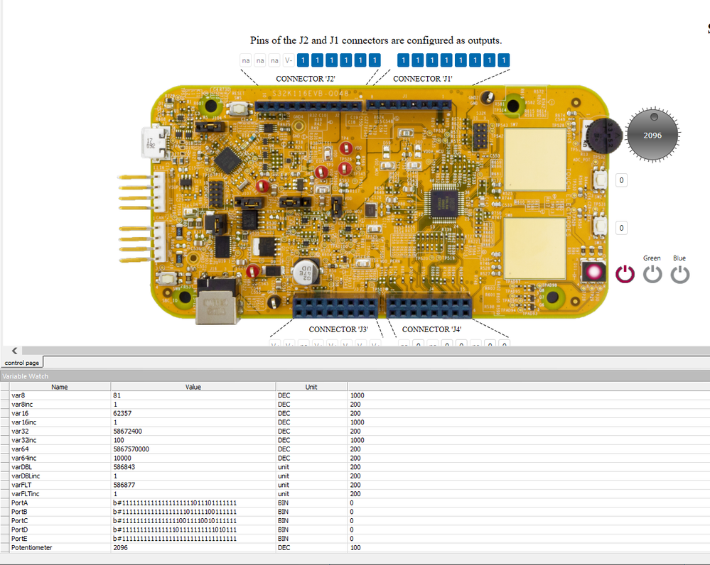

After loading the elf file, my variables are recongnized and I am able to control our newly designed S32K116 based PCB :smileyhappy:
