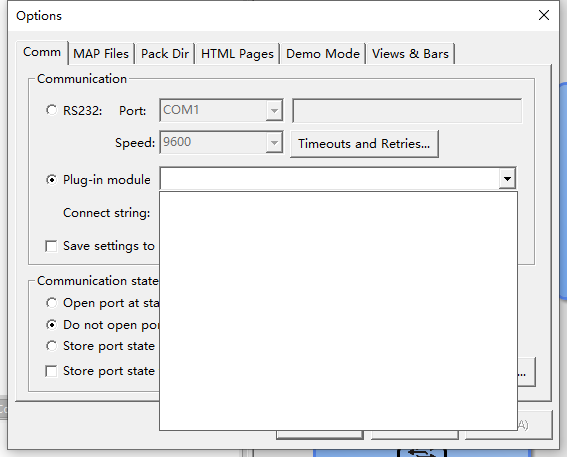

I had installed the freemaster 3.1,and I want to use the PE-micro to monitor variables ,but the Plugin-Module is NULL.Do I need to install something else?Is there any body meet this situation?please give me a hand , thanks a lot .福昕截屏20220715105304376.PNG

probably there was some problem for the installer to acquire administrator rights during installation. You should be able to fix it by running the "c:\NXP\FreeMASTER 3.1\FreeMASTER\register.bat" as administrator.
If this does not help, please re-install the FreeMASTER. First un-install the product and then install again by running the installer "as administrator".

It works, thanks for your help!
