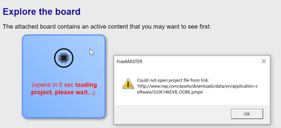

Hello, I have some difficulty with the board S32K146EVB when I try to use the demo application FreeMASTER like the quick start guide :
The board is well connected with port com3 : 115000 bd
The JumpStart project will be automaticaly downloaded from www.nxp.com Once the FreeMASTER application detects the web address stored as an TSA active content in the flash memory of the S32K146 MCU, the download of the FreeMASTER project from www.nxp.com will be initiated.
A error message appear :

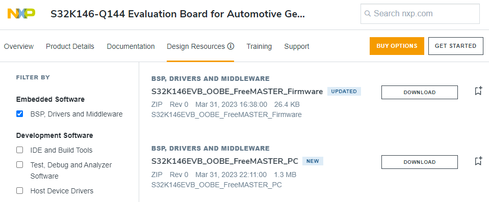

The URL issue was fixed, updated firmware can be downloaded from S32K146 product page.
FreeMASTER (PC) project is also available on the same page for offline mode.

iulian_stan
Hi @Meneglier,
Please find attached FreeMASTER project.
Open it directly in FreeMASTER tool, then connect to your board.
Kind regards,
Iulian
