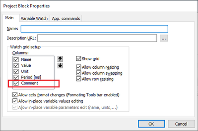

I am having an "old" project file which I moved to Freemaster 3.1. Now I can enter variable comments but I do not find any button to display them. Can you give any advice were to enable comments display?

Hello Sebastian,
for the new projects, the comment is visible in the 5th column of a Variable Watch:
When loading older projects, the column is intentionally hidden (so the project looks the same as when saved). You can show the column in Watch properties:

Hi Michal,
the only place I haven’t look
Thanks!
