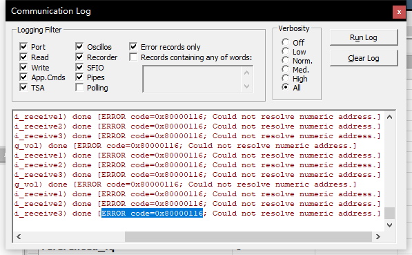

FreeMaster all variables are shown as 0
3,048 Views
352317453
"Communication"and"MAP files" is configured correctly
All variables are shown as 0.pngAll variables are shown as 0.pngCommunication log.pngCommunication log.png

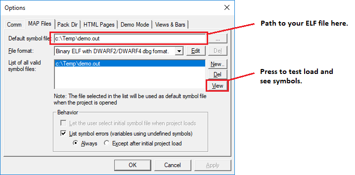

Dear user,
the issue is most likely in the ELF file parsing. Can you try to press the View button in the Project Options dialog? A text file with all parsed symbols should open:
Let me know if this works.
