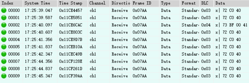

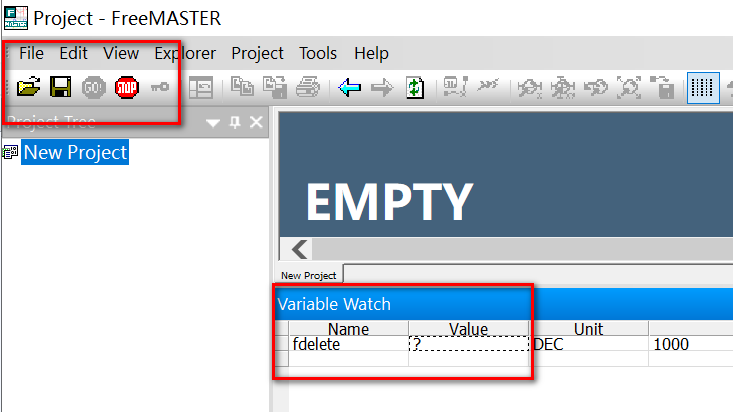

Now the CAN communication between freemaster and MCU is OK,but the variable can't be distinguished.Perhaps there is still something wrong .The attached file is the CAN messages .Can you find something wrong in it?

There can be more reasons why variable values cannot be read:
  • wrong ELF file loaded in FreeMASTER (if using ELF)
  • accessing variable not described by TSA table (if using TSA instead of ELF)
  • other problems with communication
I recommend to open Tools / Communication Debug Log and select "All" details. You should get more information about the issue.
Michal

Hi Michal,

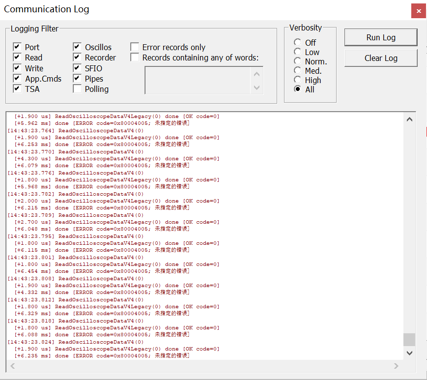

You are right.FMSTR_USE_TSA  should be defined "0" because I use ELF,and then the FreeMASTER works well.But when adding an oscilloscope,the CAN communication will be unstable and some errors appear in Communication Debug Log.The unknown error code is 0x80004005.CAN you help me solve it?

Can you tell me what CAN interface are you using on the computer? Can you try to lower the communication baudrate and make sure the CAN bus is properly terminated?
When this issue occurs, does the other variables (e.g. in Variable Watch) still work or do they show question marks?

I use ZLG device (USBCAN-II)and its baudrate is 500K.The error code occurs only when the oscilloscope is used.If I delete the oscilloscope ,the error code will disappear immediately.Even this issue occurs,the variables still work.

ok, this looks like a problem with Oscilloscope variables. Are you sure you only have "standard" 8, 16 or 32 bit variables in the scope?
Let's make few experiments:
  • Can you create an Oscilloscope with just single variable (8, 16 or 32-bit) to see if this would work?
  • Also please try defining FMSTR_USE_SCOPE to 0. In this case, the oscilloscope feature will be disabled and FreeMASTER will use general sequential reading of variables to put them to graph. Such setting is definitely not good for normal work due to much higher communication bandwidth, but we will at least test the general graphing feature.
  • For normal Oscilloscope operation, make sure you have the FMSTR_USE_SCOPE defined to 1 (or more). And also make sure to set FMSTR_MAX_SCOPE_VARS to 8 or other reasonable value.

There is just single variable(8 bit) in the scope and the FMSTR_MAX_SCOPE_VARS is 8.
The experiment results:
  • When  defining FMSTR_USE_SCOPE to 1,error code  0x80004005 occurs all the time.
  • When  defining FMSTR_USE_SCOPE to 0,error code disappears.
But it seems that no matter FMSTR_USE_SCOPE is 0 or 1,the general graphing feature is OK.
