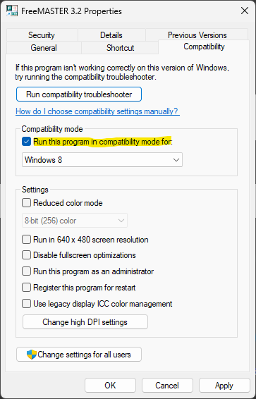

Could you try launching FreeMASTER executable in compatibility mode (eventually as admin) ?Compatibility Mode.pngCompatibility Mode.png
13,007 Views
Maurizio2
Doesnt' works. I am administator in my PC.  I have launched in compatibility mode. I have also applied compatibility mode to pcmaster.exe.
