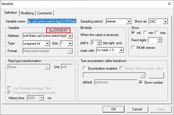

sjc230
@iulian_stan
Thanks for the information.  I have a freemaster project setup.  I can locate the variables under the project menu, but cannot locate the actual addresses.  In the address window of the variables, it has the "virtual address".  Example: "cntrState.usrControl.switchAppOnOffState".  How did you get the actual address in the projcet?
Stephen
9,280 Views
iulian_stan
The way FreeMASTER handles symbolic information (variables addresses) is described in the FreeMASTER User Guide ch. 5.2. To summarize - there are 2 options:
  1. TSA (Target-Side Addressing) this is a functionality that allows developers exposes variable information directly from the embedded application (see more information in Driver User Guide.pdf, ch. 2.2.7). It is already implemented in PMSM project. You just need to establish a connection to the target board and FreeMASTER tool will read all information automatically. Then, you should be able to see the numeric value above the address field.
  2.  ELF file - this one will extract the information from the executable file (considering debug data is not stripped) and does not require an active connection to the target board. It can be loaded from Project → Options → MAP Files
    Capture4.PNGCapture4.PNGAfter the file is loaded, addresses should be displayed just like in the previous screen-shot.
9,292 Views
