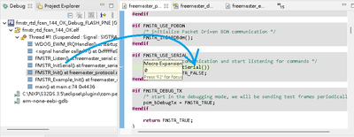

CY9
Dear iulian_stan,
There seems exist too much define in the project, cause sometimes definition mix up?
Ref:
I did NOT config and define any USRT in project, but it try to call FMSTR_InitSerial()‵ which is included in definition :
#if FMSTR_USE_SERIAL
    /* initialize communication and start listening for commands */
    if (!FMSTR_InitSerial())
        return FMSTR_FALSE;
#endif
And the `FMSTR_USE_SERIAL` is =0 now.
#define FMSTR_DISABLE          0    /* ... */
#define FMSTR_USE_LPUART       0    /* !!!!! */
#define FMSTR_USE_FLEXCAN      1
#define FMSTR_USE_PDBDM        0
#if (FMSTR_USE_SCI) || (FMSTR_USE_ESCI) || (FMSTR_USE_LPUART) || (FMSTR_USE_JTAG) || (FMSTR_USE_USB_CDC) || (FMSTR_USE_MQX_IO) || (FMSTR_USE_MBED)

iulian_stan
Hi @CY9,
FreeMASTER Driver has guards against multiple definitions. This includes communication interface definitions (see freemaster_private.h: 298)
/* only one communication link may be selected */
#if (!(FMSTR_DISABLE)) && FMSTR_COUNT_INTERFACES > 1
#error More than one communication interface selected for FreeMASTER driver.
#endif
The compiler would through an error should there be incompatible definitions.
Also, there should be no FMSTR_InitSerial symbol generated in your project if FMSTR_USE_FLEXCAN is defined.
You can check this by inspecting the .map file content or the .elf file symbols.
This output is generated in case of CAN:
C:\NXP\S32DS.3.5\S32DS\build_tools\gcc_v6.3\gcc-6.3-arm32-eabi\arm-none-eabi\bin>readelf.exe C:\fmstr_rtd_fcan_s32k144\Debug_FLASH\fmstr_rtd_fcan_s32k144.elf -s | find "FMSTR_InitCan"
   610: 00000e39    56 FUNC    GLOBAL DEFAULT    3 FMSTR_InitCan
C:\NXP\S32DS.3.5\S32DS\build_tools\gcc_v6.3\gcc-6.3-arm32-eabi\arm-none-eabi\bin>readelf.exe C:\fmstr_rtd_fcan_s32k144\Debug_FLASH\fmstr_rtd_fcan_s32k144.elf -s | find "FMSTR_InitSerial"
The second command returns an empty result.
I suspect that the clean task may not delete the old elf file or debug configuration does not trigger a full rebuild. This causes the debug session to reuse an older version of the elf file.
