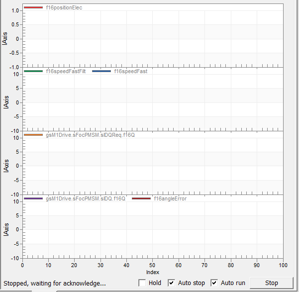

Hi there,
I have installed FreeMASTER 3.0, I didn't change communication drivers on my project. After I connect with PDBDM Variable Watch and Oscilloscopes work with no issues.
But recorder is stuck in "Stopped, waiting for acknowledgement" state as shown below.

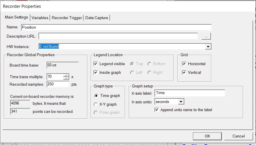

HW instance is shown as 0: not found;

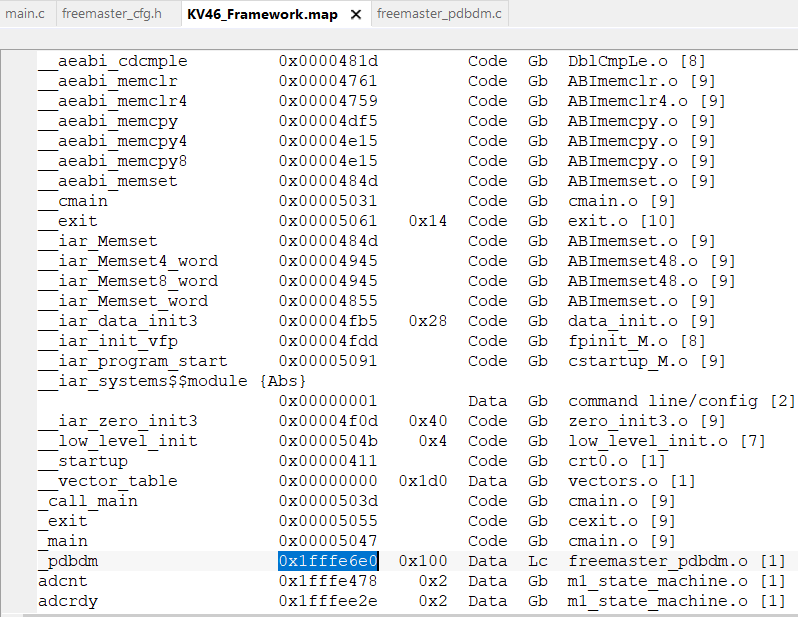

Then, instead of the old drivers, I tried to set up the new drivers and gave a shot. Found the communication buffer in my .map file;
But FreeMASTER doesn't find the buffer address. Manually typing the address will not result in making the connection.

the FreeMASTER 3.0 should work well with old driver and old protocol implementation on all transports - including the PDBDM. It is normal that the Recorder settings shows the recorder 0 as "not found" - this is because the old driver version does not assign any name to that recorder instance. We should have probably called it "0:default", to avoid such confusion.
We have identified an issue with manual recorder stopping when the old driver is used - and this is probably what you are facing. The fix will appear in the upcoming release. The issue only affects manual stopping, recorder should still stop fine when a recorder is stopped by a trigger variable.
You can try a patched version of the communication DLL which should address this issue. Just copy DLL from this link to FreeMASTER installation folder..

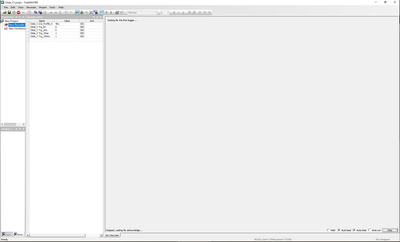

Sam_ECU
Contributor V
Hello @MichalH
I have the same issue:
I've installed the latest version:
The recorder was working for me.  I haven't made any changes to Freemaster or Simulink.
I tried using the dll within this chat, it didn't work either.
Sam

6,876 Views
burakgorduk
Thank you for the response. The patched DLL fixed the issue as you've said. I can use Freemaster 3.0 with my old comm. drivers without any issues.
