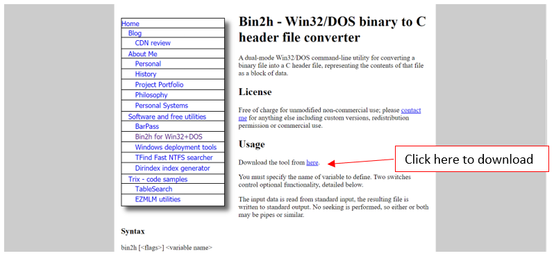

To do this we can use the bin2h application, we are going to explain how to do it with bin2h but you are free to use any other method at your disposal. To download bin2h go to http://www.deadnode.org/sw/bin2h/:
The bin2h program is a command-line utility so we need to open our command-line interpreter of preference to use it (in this example we are going to use the Windows Command Prompt). Open your command-line interpreter and go to the direction where you downloaded the bin2h program (you can also add it to your Path environment variable so you can access bin2h from anywhere, you can see how that is done from https://www.java.com/en/download/help/path.xml).

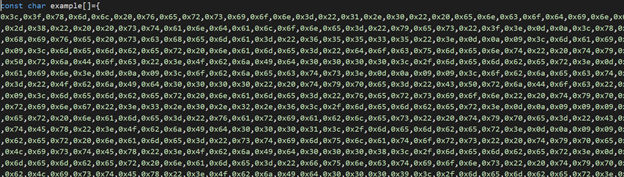

This will generate a data_example.h file containing a character array with the name example:
data_example.h contains:
At the end of the file another variable with the size in bytes of the array:

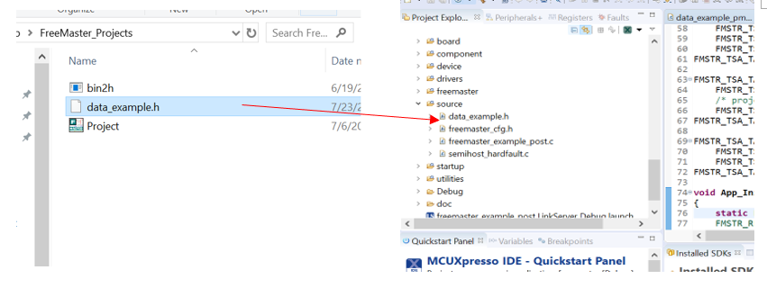

After creating the data_example.h file, we need to pass it to our source folder in the MCUXpresso project of our embedded application (remember for this document we are using the project example from https://community.nxp.com/docs/DOC-347236):

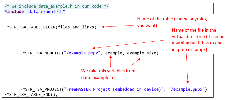

TSA uses tables to describe the information and data we want to share with FreeMaster. We will need to create a new table with the description of the memory-mapped file of our FreeMaster Project (the data_example.h file).
In the c file of our application we add:
/* We include data_example.h in our code */
#include "data_example.h"
FMSTR_TSA_TABLE_BEGIN(files_and_links)
 FMSTR_TSA_MEMFILE("/example.pmpx", example, example_size)
 /* projects to be made available in FreeMASTER */
 FMSTR_TSA_PROJECT("FreeMASTER Project (embedded in device)", "/example.pmpx")
FMSTR_TSA_TABLE_END();‍‍‍‍‍‍‍‍‍‍‍‍‍
In this example, we named the table files_links to describe the content of the table, but it can be anything name we want. We use the FMSTR_TSA_MEMFILE to indicate the variable where our file is memory-mapped, it takes as arguments the name we are going to refer the project file when we are running the FreeMaster application (it has to end with pmp or pmpx so FreeMaster knows is a project file), the variable that contains the memory-mapped file and the size of that variable.
With FMSTR_TSA_PROJECT we facilitate the access to the FreeMaster project from the FreeMaster application, it creates a hyperlink to the project from the welcome page in FreeMaster, we need to indicate the text of the hyperlink and the name of the project file (the one we set up with FMSTR_TSA_MEMFILE), in the welcome page it will look like this:

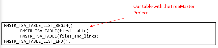

After we create the table we need to add it in our table list (in this example we already have another table for our variables):
FMSTR_TSA_TABLE_LIST_BEGIN()
 FMSTR_TSA_TABLE(first_table)
 FMSTR_TSA_TABLE(files_and_links)
FMSTR_TSA_TABLE_LIST_END();‍‍‍‍

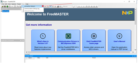

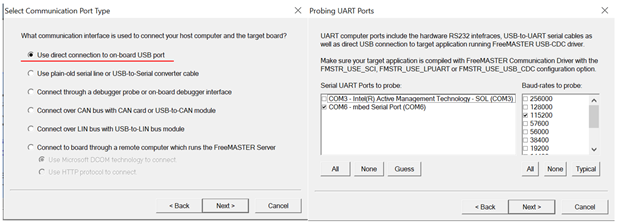

Now let’s run the project from our embedded application, first open FreeMaster software and use the Connection Wizard to connect with your board:
Use the “Use direct connection to on-board USB port” option and select:

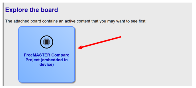

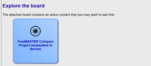

After that in the Welcome Page, you will see a new box-button under the “Explore the board” section of the Welcome Page:

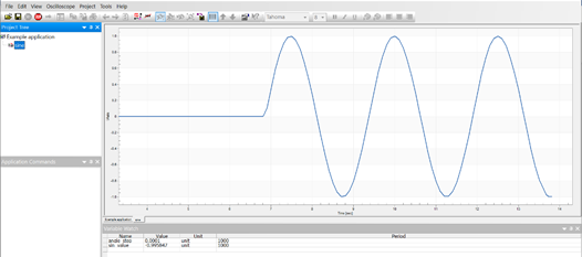

Click on the button and the project will open, you can see that FreeMaster tools like the oscilloscope and configurations for the Variable Grid have been imported from our FreeMaster memory-mapped file. The FreeMaster project should look the same as when we created it.
