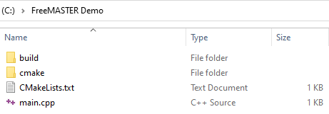

  3. Create a build folder in your workspace and open a terminal window in that folder.
    At this point your workspace should look like this:

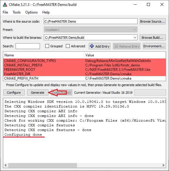

  4. Configure custom project (using Visual Studio 2019):
    cmake .. -G "Visual Studio 16 2019" -A "Win32" -DCMAKE_PREFIX_PATH="C:/FreeMASTER Demo/cmake"

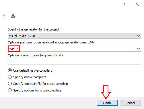

    Note: FreeMASTER comes with a 32 bit library, thus I specified Win32 architecture. Additionally, I set CMAKE_PREFIX_PATH pointing to the downloaded cmake folder.
    In case FreeMASTER is installed in a custom location you need to define FREEMASTER_ROOT pointing to FreeMASTER Lite installation directory (root of include and lib folders) "-DFREEMASTER_ROOT=path_to_FreeMASTER_Lite".
    After this command is executed you will find the generated solution in the build folder.

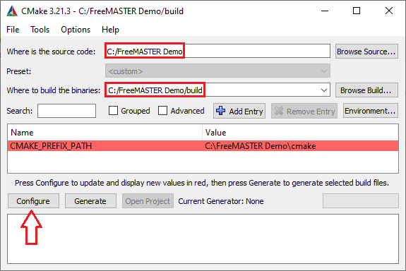

    Same steps can be done using CMake GUI:

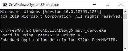

Running the code
After building the project make sure to copy the library next to your executable or add its folder to system path and run fmstr_demo.exe.
