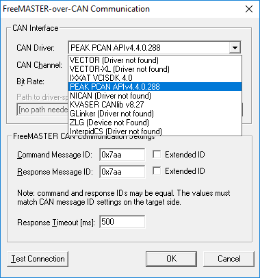

So, first of all: this is how it should look like. Are you sure it is not there?

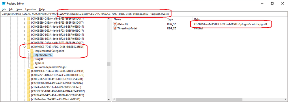

Check that the CAN plug-in is registered. In regedit, please locate this node (I assume you have 64-bit Windows):

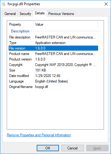

Locate the "c:\NXP\FreeMASTER 3.0\FreeMASTER\plugins\can\focpgi.dll"  and display properties. The version should be 1.6.0.0

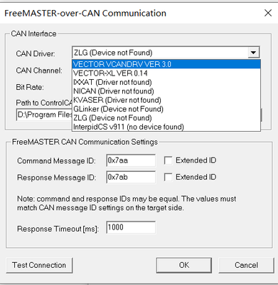

Need to follow the latest version of freemaster2.5 to support PCAN
Can you provide the latest version of freemaster2.5? Otherwise, PCAN devices cannot be found
