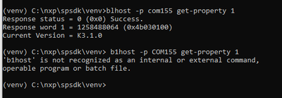

I tried your first command and the issue that's there is a "1" instead a "l". If you copied and pasted, there might be a typo.
I did try that "b1host" as an experiment as well as blhost (correct) and accidentally left it in the example I posted. But it was not the issue, both failed. It only executed correctly when I included the path. Will verify again tomorrow.

I do not see the same error when calling blhost in the typical command prompt. It looks like it is recognized as a function, maybe just some syntax issue:
