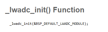

    2. Just below where you initialized the switches (with the init_switch() function) in InitTask.c use the lwadc_init() function to initialize ADC 1. ADC 1 will be used because the potentiometer is connected to ADC 1 on the tower K70 board. We'll see this in a moment. ADC 1 is the default ADC controller in this BSP and there is a define for this in the board specific BSP file (twrk70f120m.h) called BSP_DEFAULT_LWADC_MODULE. So you can use this define to point to the ADC1 init structure or more directly use 'lwadc1_init'. Note that the extern for BSP_DEFAULT_LWADC_MODULE is missing in some versions of MQX so you may need to add an 'extern const LWADC_INIT_STRUCT BSP_DEFAULT_LWADC_MODULE' at the top of InputTask.c.

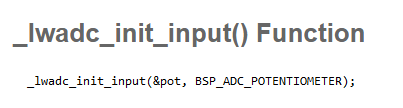

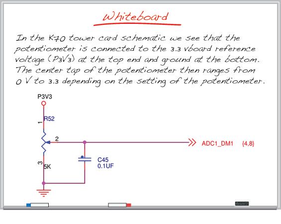

    3. This will initialize the ADC device but the next step is to initialize the data structure for the input to this ADC Device. This is done with the lwadc_init_input() function. Don't forget to declare a structure of type LWADC_STRUCT. As with all inputs, you will find in twrk70f120m.h, a define for the ADC input from the potentiometer. It is called BSP_ADC_POTENTIOMETER and it is set it to (ADC1_SOURCE_AD20). This defines the ADC Device that it is connected to and the pin muxing.

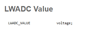

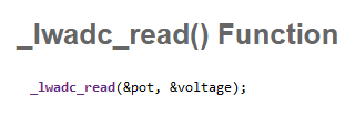

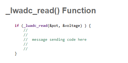

    1. Now we're ready to read the input. You will recall that in the endless loop of our Init Task it will wait indefinitely for either a switch or ADC event bit to be set, and once one of these bits has been set the appropriate action is taken. We added the setting of the ADC event bit in the last lab with the use of a timer. Currently when this bit is set the Input Task will send a message to the Health Task but we don't have any real data to send so our job is to add that data now. Before sending the message the Input Task should use the _lwadc_read() function to get the setting of the potentiometer. You will need a variable of type LWADC_VALUE for the reading from the ADC to be written to.
    2. Update the data field in the message to the Health Task to be the read value from the ADC.
    3. Since the _lwadc_read() function returns TRUE if the read is successful and FALSE if the read was unsuccessful it would make sense to update your code to only send a message if the read from the ADC was successful.

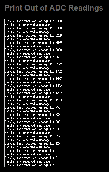

    2. On the print out you should see the Health Task and Display Task message ADC messages being displayed continuously (officially once every 100 msec because that's the period of our timer that triggers the reading of the ADC). If you change the setting of the potentiometer on the K70 tower card the value printed out should change and the readings should range from 0 (or close to it) to 3300 (or close to it) to represent 3300 millivolts.

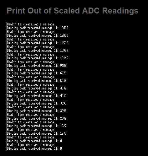

    1. As you saw the input wasn't scaled at all, it simply showed you the voltage (in millivolts) that the ADC was reading. But you may want to scale the input to a range that is more meaningful. Instead of having the input range from 0 to 3300 we want to scale this so it ranges from 0 to 12000. This could represent a temperature that goes up to 1,200 degrees (in tenths of a degree) or a voltage range that goes up to 12 volts (measured in millivolts). Use the _lwadc_set_attribute() function to change the scaling. Try this on your own, if you need a hint use the whiteboard.
    2. Change the reading of the ADC to return an average value over 8 reads. This requires the _lwadc_read_average() function.
TESTING THE SCALING
  1. Compile and run your code.
  2. Confirm on the output that the range of the potentiometer is now from 0 to 12000.
