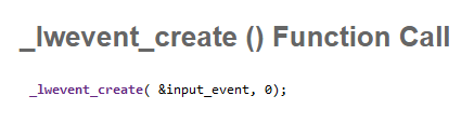

    3. The LW Event will have to be created so in the initialization section of the Input Task you need to call _lwevent_create(). In this case we do not want the flags to auto clear.

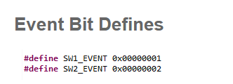

    4. Since we are using events to indicate the pressing of the switches we need to specify the specific bit being used for each switch. At the top of InputTask.c create a define that specifies that bit 0 of the event group will indicate the status of switch 1 (ie a define set to 0x0000001) as well as a define that specifies that bit 1 of the event group will indicate the status of switch 2 (ie a define set to 0x00000002).

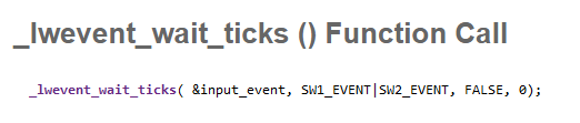

    1. Since the input task is only responding to a press of one of the switches there isn't anything for it to do until this happens. The most efficient way to handle this is to have the Input Task wait indefinitely until one of the event bits of interest have been set. This can be done using the _lwevent_wait_ticks() function. Both event bits will need to be specified with the call waiting on either of the bits to be set, not both, and in order for the call to wait indefinitely specify a timeout of 0.

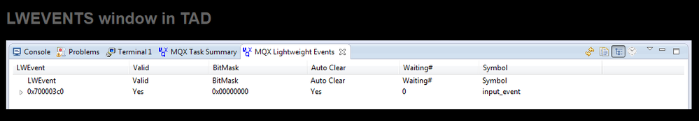

  2. Put a break point in the Input Task code on a line just after the _lwevent_wait_ticks() call. Press switch 1 on the tower board and when the break point is hit use task aware debugging to view the lightweight events status window. Bit 0 should be set in the event group.
  3. Run the code and press the other switch on the tower card. The task aware debugging window should show only bit 1 is set.
  4. Remove your break point and update the creation of the lwevent group so the bits are auto clearing by using the LWEVENT_AUTO_CLEAR flag in the _lwevent_create() function. Then remove the _lwevent_clear() function calls and confirm that the system behaves in the same way that it did before.
  5. Put a break point back in the same location that you did previously and confirm that despite a switch being pressed the bits are auto clearing and that neither bit 0 or bit 1 are set in the lightweight events status window.
