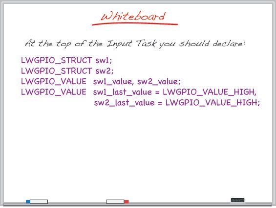

    3. In the Input Task we'll need to declare a few variables of different structure types associated with LWGIO. At the top of the function where the variable declaration is done add variables sw1 and sw2 both of type LWGPIO_STRUCT. We also need to know the value of sw1 and sw2 so declare variables sw1_value and sw2_value of type LWGPIO_VALUE. Finally, to retain the previous value of each switch we'll need two more variables of type LWGPIO_VALUE called sw1_last_value and sw2_last_value.

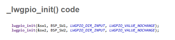

    4. In order to use an I/O on the processor it has to first be initialized to define how you want to use it. In the initialization section of the Input_Task use the _lwgpio_init() function to initialize the input pin connected to sw1 and again to initialize the input pin associated with sw2. The ID for each pin is defined in the BSP for the card you are using, in this case twrk70f120m.h which can be found in the BSP_Files folder of the BSP project. Since these we are using these pins as inputs we can use an initialized value of LWGPIO_VALUE_NOCHANGE.

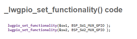

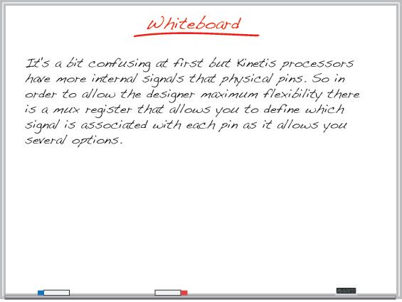

    5. We also have to set the functionality for each pin and _lwgpio_init() doesn't set the actual pin mux register, meaning that we haven't defined that the associated pins on the processor should actually be used as IO. Use the _lwgpio_set_functionality () function to define the associated pins as inputs. The defines for the different functionality options for the IO pins are defined in the same BSP file (towrk70f120m.h), ie BSP_SW1_MUX_GPIO is used to set pin D0 the internal signal for sw1 and BSP_SW1_MUX_GPIO associates pin E26 with the internal signal for sw2.

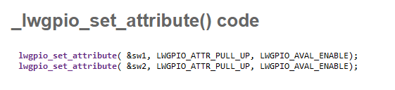

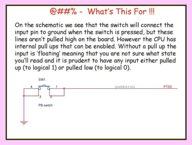

    6. Since the circuits on the tower board for the switches don't have pull up resistors you need to enable the internal pull up resistors using the lwgpio_set_attribute () function.

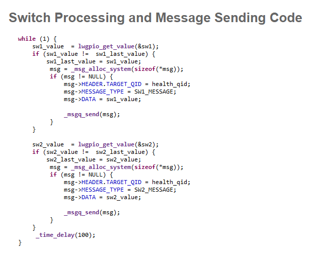

    1. First thing to do in the endless loop of the Input Task is to read the value of the switches using the _lwgpio_get_value() function and store the result in sw1_value and sw2_value.
    2. If the read value is not the same as the previous value, it must have changed so this is when we send a message to the Health Task. Copy the code we had before for sending a message. Update the message type (either SW1_MESSAGE or SW2_MESSAGE) and instead of sending data of 0 like we did before we can send the switches value (sw1_value or sw2_value). We are detecting switch state changes by comparing the current value to the last value so now that we've detected a change the current value should be copied to the last value.
    3. If you haven't thought about this already we could get a false change of state detection on power up if sw1_last_value and sw2_last_value are not initialized. Since the read value will be a 1 when the switch is not pressed it would be a good idea to pre-initialize the last value to a 1 (LWGPIO_VALUE_HIGH).
    4. Change the time delay in the endless loop to 100 ms to make sure we catch every press of a switch.

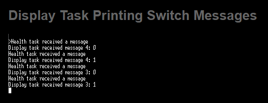

    1. Since we are now sending actual data in our messages it would be good to have the Display Task print out the switch state when an update is received. To do this update the printf in the Display Task to show this parameter as well which is being passed in the data field of our message.

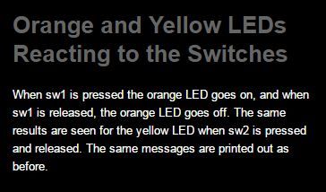

    2. Compile and run the code.

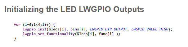

  4. In the initialization section of Display Task we need to initialize the IO pins associated with the LEDs in a similar way to how it was done for the switches. However we now want to set the direction as being an output (LWGPIO_DIR_OUTPUT) and the initial value should be high with a value of high (LWGPIO_VALUE_HIGH) because we want the output of these pins to reflect the value of the corresponding switches and those are defaulted to high (remember the pull ups?).
  5. As was also done with the IO for the switches we need to set the functionality for the corresponding pins so they are configured as IO. You'll need the define from the BSP header file again (eg: BSP_LED1_MUX_GPIO)
  6. Since there are 4 LEDs to initialize you could consider using a for loop for the initialization to keep things cleaner.

  7. Compile and run the code.
