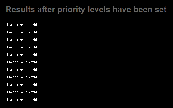

    3. Run your code and observe the output on the terminal. Pause the execution and observe the Ready Queue in TAD.

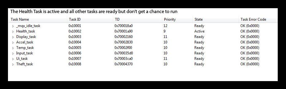

    1. With Round Robin Scheduling we saw that a schedule yield from the active task allowed the next task in the ready queue to run. That doesn't work though when you have tasks at different priorities and the only way a higher priority task will yield the CPU to a lower priority task is to enter a blocked state. So our use of a time delay before wasn't such a bad idea after all. Change the sched_yield call in the Health Task to a one second time delay and see what happens. You may have to put a break point on the time_delay in the Health Task in order to catch its printout.

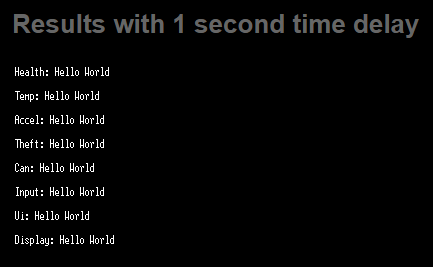

    2. We now have a means for the high and medium priority tasks to run so we need to extend this to allow the low priority tasks to run as well. Since we currently don't have a means of unblocking from any of the blocking calls other than a time delay we'll have to stick with that for now, but these will all eventually be replaced. Update all tasks now to use a one second time delay in lieu of the schedule yield. Now see what results you get.

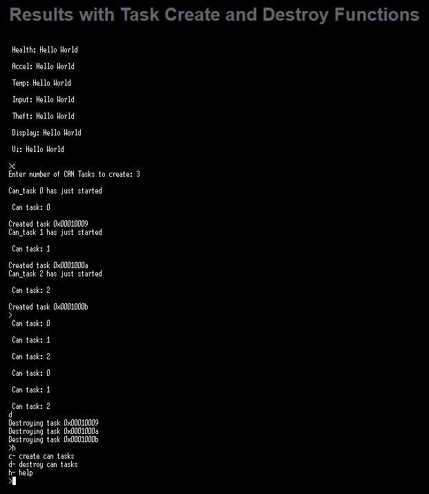

  2. To try out your changes create a number of CAN Tasks using your new interface and then pause the program. Check that the requested number of CAN Tasks exist in the task summary window in TAD. Delete all CAN Tasks using your interface and ensure that they are removed from the Task Summary window.

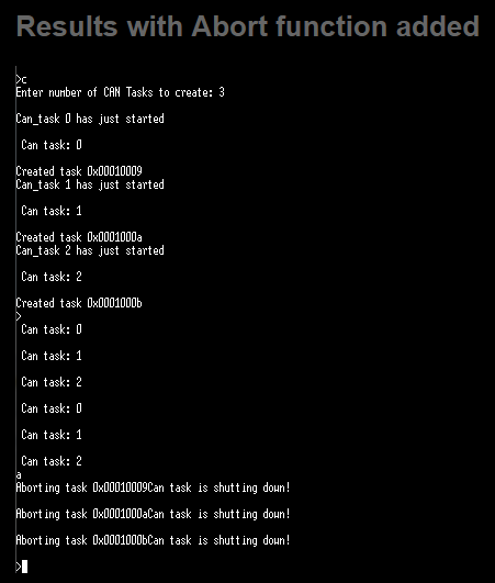

  3. Now add an additional command to your UI to allow the user to abort the CAN Tasks instead of destroying them by entering in an 'a'. The abort function allows the task being terminated to run an exit handler before termination so we'll add an exit handler to the CAN Task. The exit handler is a separate function outside of the can_task() function and it should be put in CanTask.c. For now all that the exit handler will do is print out a message that the task is shutting down. In order to access the exit handler the CAN Task will need to install the exit handler in its initialization code using the task-set-exit-handler() function.
  4. Run your code and verify that when the abort command is entered all CAN Tasks will print out the shutting down message but they don't print this message when the destroy message is used.

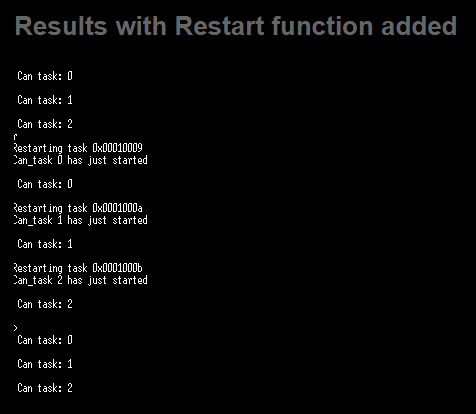

  5. Finally, add one more command to your UI to restart the CAN Tasks by entering an 'r'. In order to see when a task has started add a printf in the initialization section of the CAN Task code that indicates that the task has just started with the ID parameter passed to the CAN Task.
