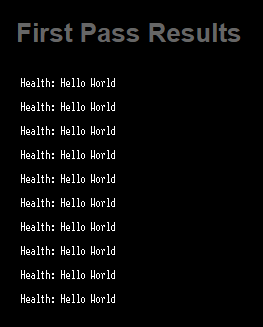

    2. Since in a real system tasks typically run indefinitely the code for each task should be modified so they print their unique message continuously.
    3. Once these changes have been made compile and run the application. Observe the print out. Is this what you expected? Why do you think this happened?

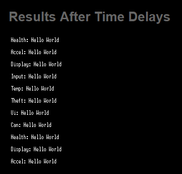

  3. Since the use of a time delay allowed the next task to run, putting a 1 second time delay after the print statement in all tasks should allow for better cooperation. Try this and re-run the application.
  4. Did you get all print messages? If so, what is the downside to this method ensuring shared use of the CPU?

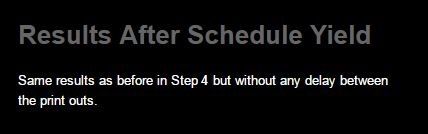

  5. Try replacing all of the time delays with the schedule yield function (_sched_yield() ). Run your code and compare the results.
