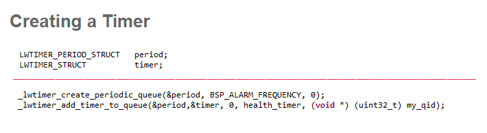

ADDING A TIMER
    1. In order to set up a timer we'll need a structure to be declared in the Health Task of type LWTIMER_PERIOD_STRUCT and another one of type LWTIMER_STRUCT.
    2. In the initialization section of the Health Task create the periodic queue with the _lwtimer_create_periodic_queue() function that has a period of 1 second and no wait time. Note that for this BSP of MQX the define BSP_ALARM_FREQUENCY is set to 200 ticks and each tick is 5 msec, so it represents 1 second. Then add a timer to the queue using the _lwtimer_add_timer_to_queue() function. You do not need an offset and the timer should call a 'health_timer' ISR function that will be defined later. The parameter to pass is the Health Task Queue ID. Note that the 'my_qid' variable isn't valid until after the _msgq_open() function so these new lines should go after the _msgq_open() call.

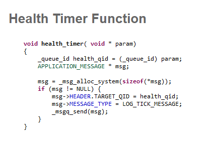

CREATING THE TIMER FUNCTION
    1. At the top of HealthTask.c create the 'health_timer' function that will be called when the timer expires. It will receive the Health Task's queue ID as its only parameter, which will have to be converted into a '_queue_id' type.
    2. This function will send a message to the Health Task essentially to let it know that it's time to write a log entry of the current values. As was done elsewhere in the application, declare a message of type 'APPLICATION MESSAGE *', set the target queue id, set the message type to be 'LOG_TICK_MESSAGE' and then send the message. That's all that this function needs to do. This new message type needs to be added to the 'APPLICATION_MESSAGE_TYPE_T' data structure in main.h.

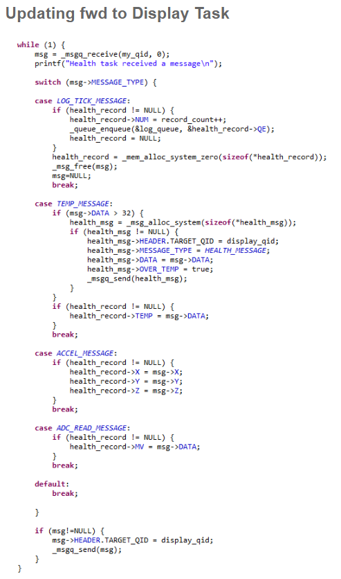

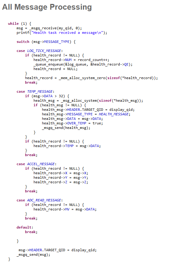

UPDATE THE PROCESSING OF MESSAGES

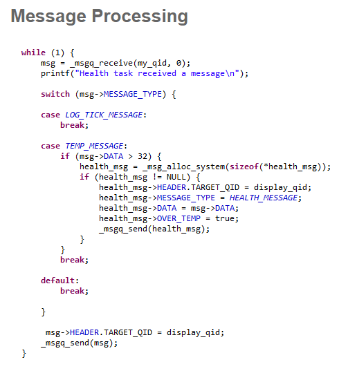

    1. In the while(1) loop of the Health Task it checks if an incoming message is from the Temp Task, and if there is an over temperature condition a message is sent to the Display Task. The Health Task now needs to be processing several types of messages so it would make sense that a switch statement on the received message type is used. Add a case to the switch to handle messages of type TEMP_MESSAGE that will contain the same functionality that is already in the while(1) loop for messages of type TEMP_MESSAGE. And add another case for messages of type LOG_TICK_MESSAGE which for now won't do anything, we'll fix that later.

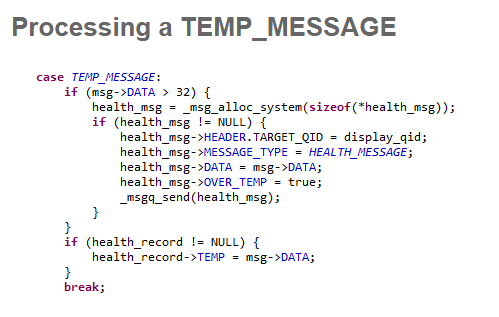

    2. When a TEMP_MESSAGE is received we need to store the passed in temperature, so in the case that handles TEMP_MESSAGEs update the "TEMP" parameter of the health record to be the passed in temperature in this message. Here is where it would be a good idea to first check if our health record != NULL.
    3. Add in a case for ACCEL_MESSAGEs which will record the passed in x, y, and z axis motion values into the health record, assuming it's valid.
    4. Add in a case for ADC_MESSAGEs which will record the passed in voltage into the health record, assuming it's valid.

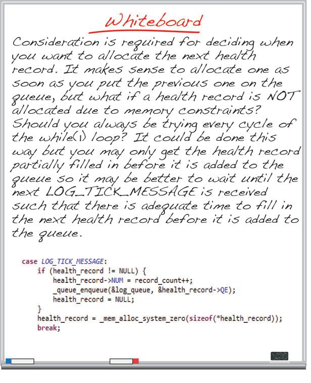

    5. We are now ready to add the handling of a LOG_TICK_MESSAGE. Since the health record has been updated when the other messages were processed we only need to save the record number (count) into the health record, increment the record number for next time, and then add this health record to the queue using the _queue_enqueue() function like this:
      _queue_enqueue(&log_queue, &health_record->QE)
    6. The Health Task is done with the health record since it just put it on the queue so the 'health_record' pointer should be set to NULL so the rest of your code doesn't try to use it. A valid health_record pointer is required for the next record of course and it is required now so its fields can be filled in as new messages arrive. Use the _mem_alloc_system_zero() function as was done before to allocate memory for another record.
    7. Currently, at the end of the while(1) loop all received messages are being passed on to the Display Task. However, we don't want to pass on messages of type LOG_TICK_MESSAGE so the code needs to be updated such that it only passes on the other types of messages. This could be done with a test for msg->MESSAGE_TYPE != LOG_TICK_MESSAGE condition, but to be more generic and accommodating of future message types that shouldn't be passed on to the Display Task it might be better for the handling of the LOG_TICK_MESSAGEs to free the message using the _msg_free() function and to set the 'msg' pointer to NULL. Then at the end of the while loop check that only non-NULL messages are sent to the Display Task.

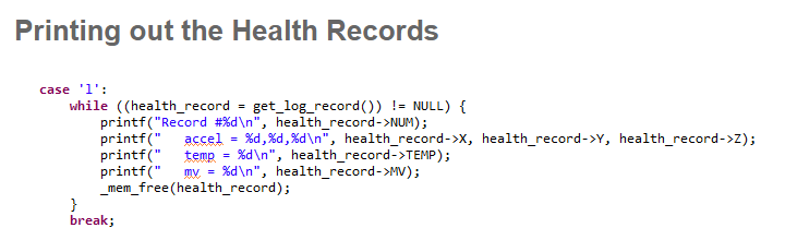

UPDATING THE UI TASK
  1. It is intended that the health records can be printed out using the UI Task. This is a menu driven interface and so we need to add a new command to read the log file. In UiTask.c add a case for the user pressing the letter 'l' (lower case L) for the log file and get the health record from the queue using the queue_dequeue() function. It can be a good idea to us a small function for items like this since there can be multiple places in your code that need to do a similar task. Such a function could look like this:
    HEALTH_RECORD  *      get_log_record(void)
          return (HEALTH_RECORD * )   _queue_dequeue(&log_queue);
  2. Add print statements for the record number and all other data that is in the health record. Free up the memory of the health record once you're done with it to avoid a memory leak.

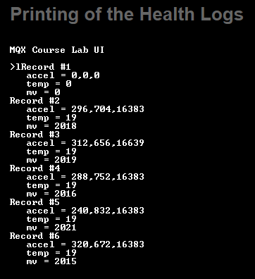

  3. This will cover the printing of the first record but the intention is for this UI command to print out all health records that are stored on the queue. Use a while loop to fetch records from the log using our new get_log_record() function until this function returns a NULL entry indicating that there are no more records to fetch from the queue. Note that the function returns a pointer to a HEALTH_RECORD, so a variable in the UI_TASK of this type will have to be declared.
  4. Compile and run your code. Use the user interface to request the health logs to be printed out and confirm that the data is correct. You can adjust the potentiometer and move the tower board to change the data. You may also want to comment out the print messages from the Health Task and Display Task so these messages don't interfere.
