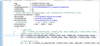

I am trying to read data from 17MB location from the flash connected. Tried below changes for accessing flash
Made changes in the evkmimxrt1170_flexspi_nor_config.c for the flash size that is 64MB and added custom LUT for accessing 4 byte addressing. Please check below screenshot
What are the changes that I need to perform to access flash greater than 16MB?
Flash - IS25LP512M
Controller - IMXRT1172
IDE is MCUXpresso 11.6.0
