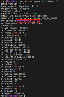

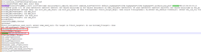

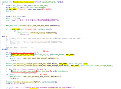

baimahe
Uboot has already configured the environment variables ethaddr and children's and addr, but what is obtained in the kernel is a random MAC address
