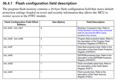

hello dears ,
as the upper show , I found it in S32K-RM.pdf .
I feel a little confused about this,  the flash configuration filed is in the PFLASH area.
then if I donwload a big code which is bigger than 0x0000 040f, whether this flash configuration field will be overwritted or not ?

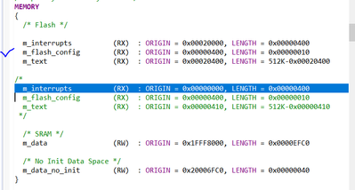

alan_yu
support by myself !!!!!!!!!
within S32K144_64_flash.ld file,some configuration for this area , so it should be not overed by app code.
