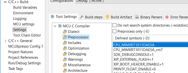

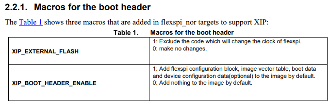

Demos on MCUXpresso are by default XIP so you can use a demo project as a starting point. For example once you import the Hello World example, if you go to the Preprocessor defines you will see that XIP_External_FLASH=1 and XIP_BOOT_HEADER_ENABLE_=1. You can find more information on how it all works here. This appnote is for 1050, but same ideas apply to 1010.
-Alex

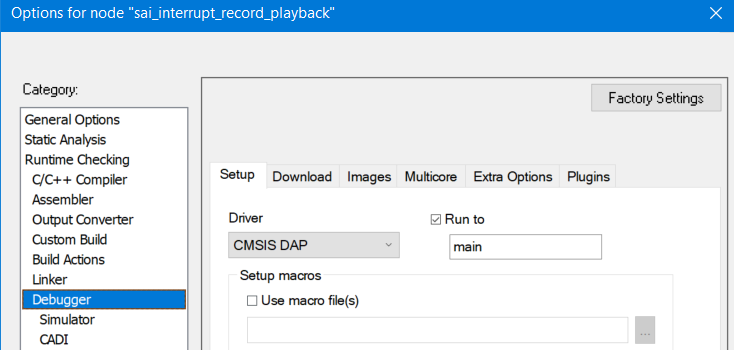

I have downloaded the app note code and IAR tools. With the EVK plugged in IAR tools cannot find a debug connection. It seems to be looking for a J-Link connection. Is a J-Link debug connection required or can the debug connection built into the RT1010 EVK be made to work? How is that done?
Best Regards
Tom M.
6,273 Views
alex_rodriguez
Tom,
To change the debugger settings go to Project->Options->Debugger and select CMSIS DAP.
If you will be using the external flash, go to the download tab and select "Use flash loader"
-Alex
