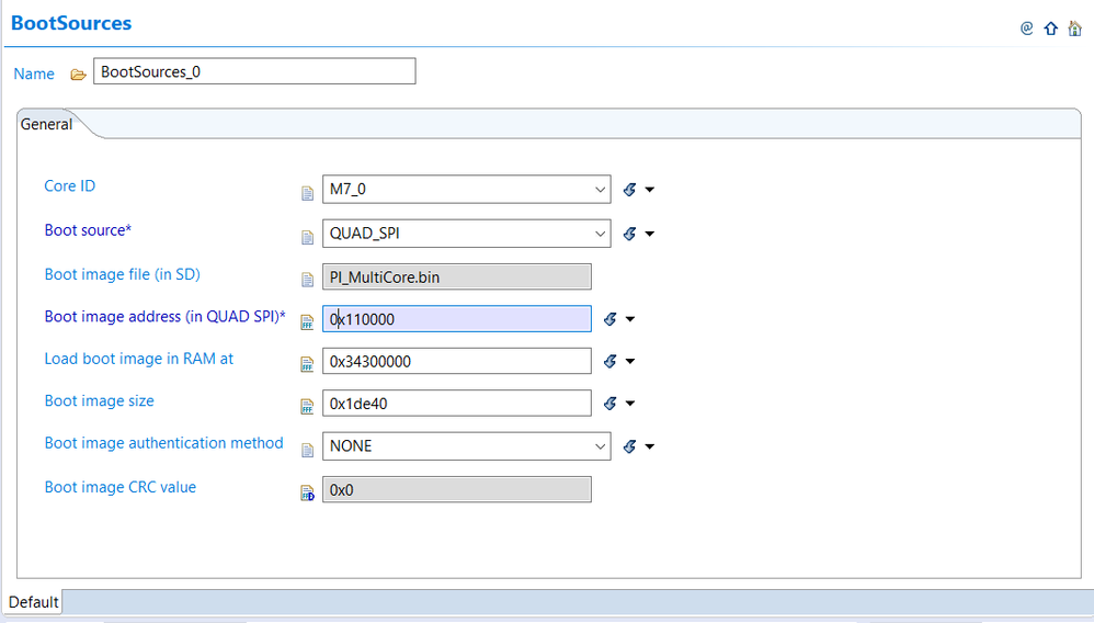

The bootloader application example can use two types of Boot Sources: SD or QuadSPI for the images.
If user does not want to use SD as a source, several steps need to be executed:
1. Update the Bootloader Configuration by selecting QUADSPI instead of SD as a boot source for all the configured images, where applicable.

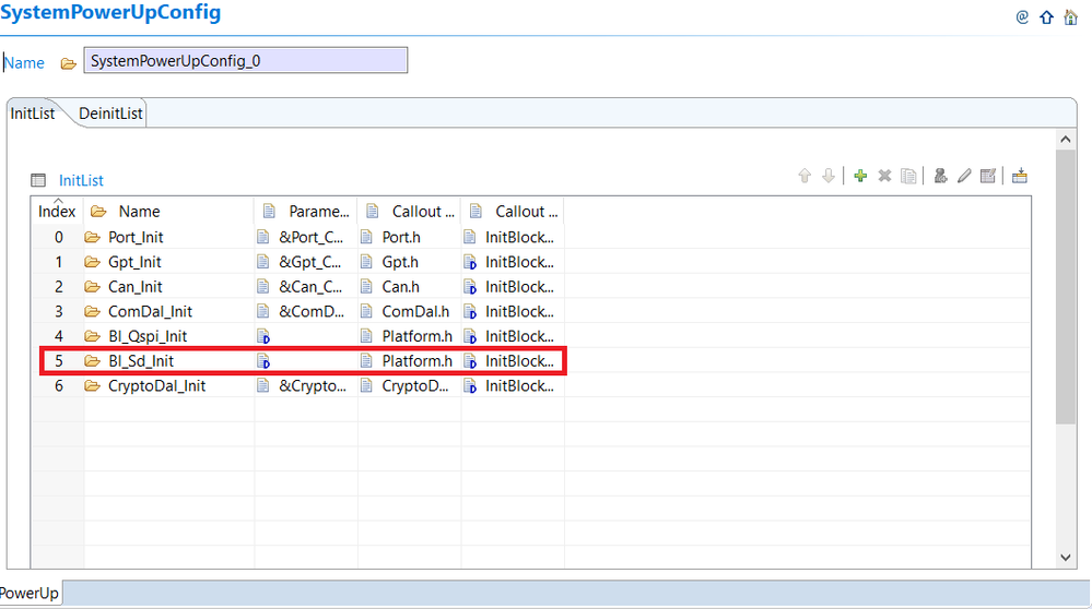

2. Initialization/De-Initialization sequence must be updated.
      a. Go to SysDal plugin, PowerUp, InitList and remove the Bl_Sd_Init entry from the list.

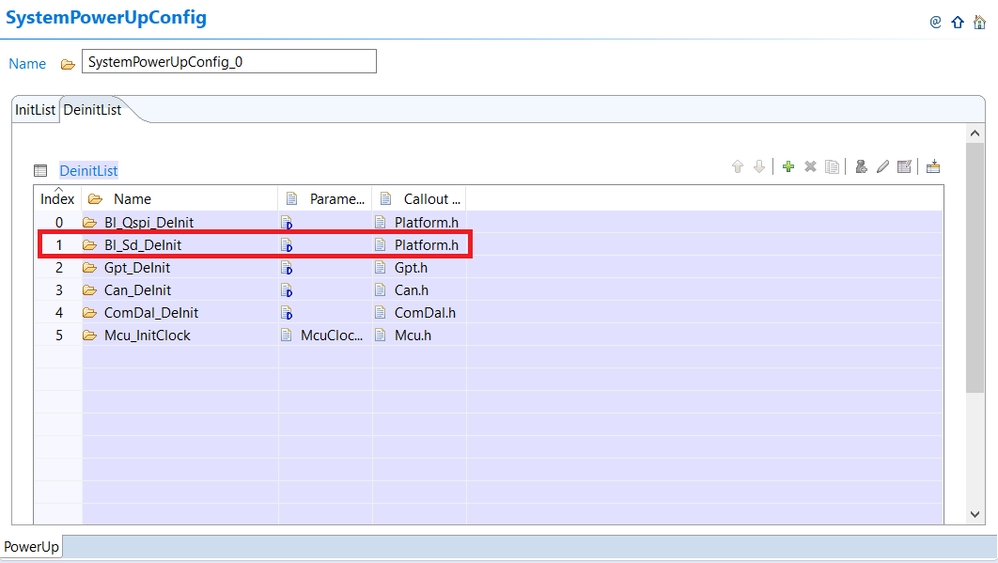

      b. Go to SysDal plugin, PowerUp, DeInitList and remove the Bl_Sd_DeInit entry from the list.

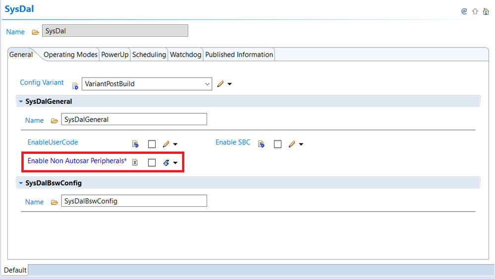

3. Disable Non Autosar Peripherals from SysDal plugin by deselecting the Enable Non Autosar Peripherals tick box.
Regenerate the code for the current workspace and build.
