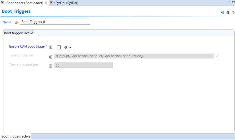

1. Disable the Enable CAN boot trigger tick box from the Bootloader configuration plugin.

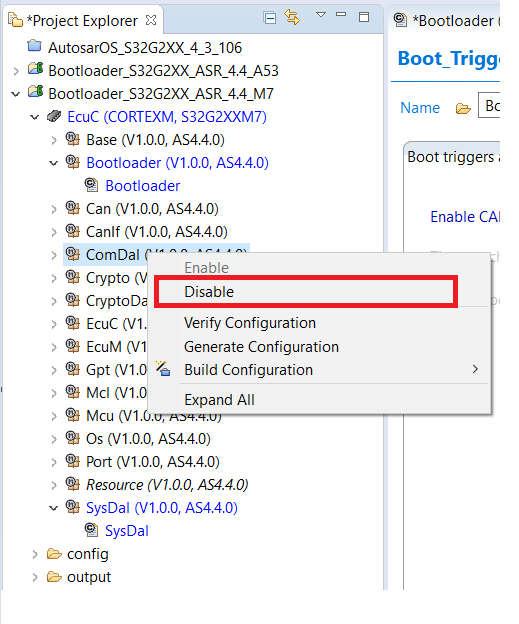

2. Disable ComDal, Gpt, Can and CanIf plugins, by right clicking on each of the plugins and selecting the Disable Module.

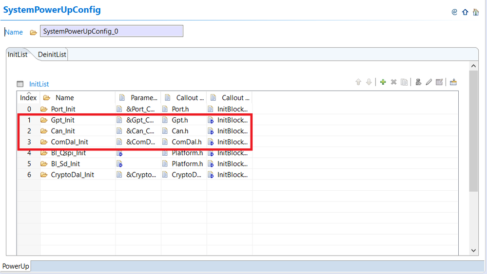

   a. Select the SysDal plugin, go to PowerUp, InitList and remove Gpt_Init, Can_Init and ComDal_Init entries from the list:

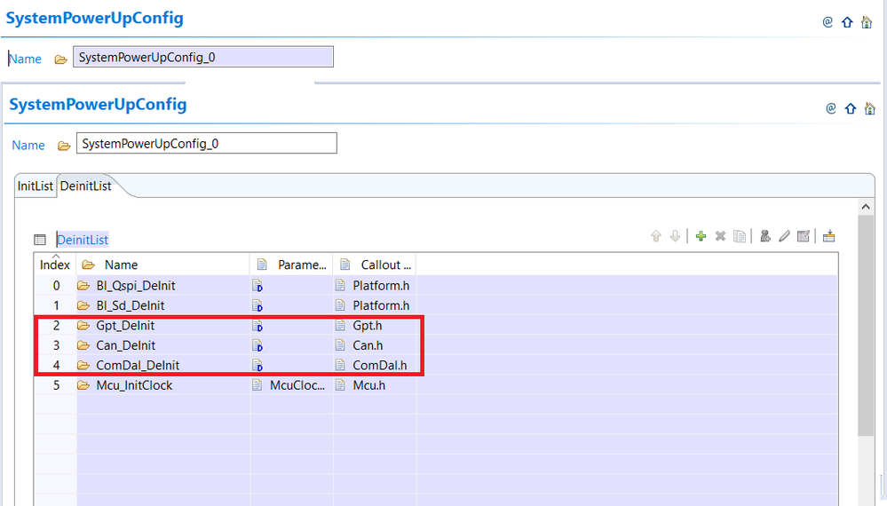

   b. Select the SysDal plugin, go to PowerUp, DeInitList and remove Gpt_DeInit, Can_DeInit and ComDal_DeInit entries from the list:
