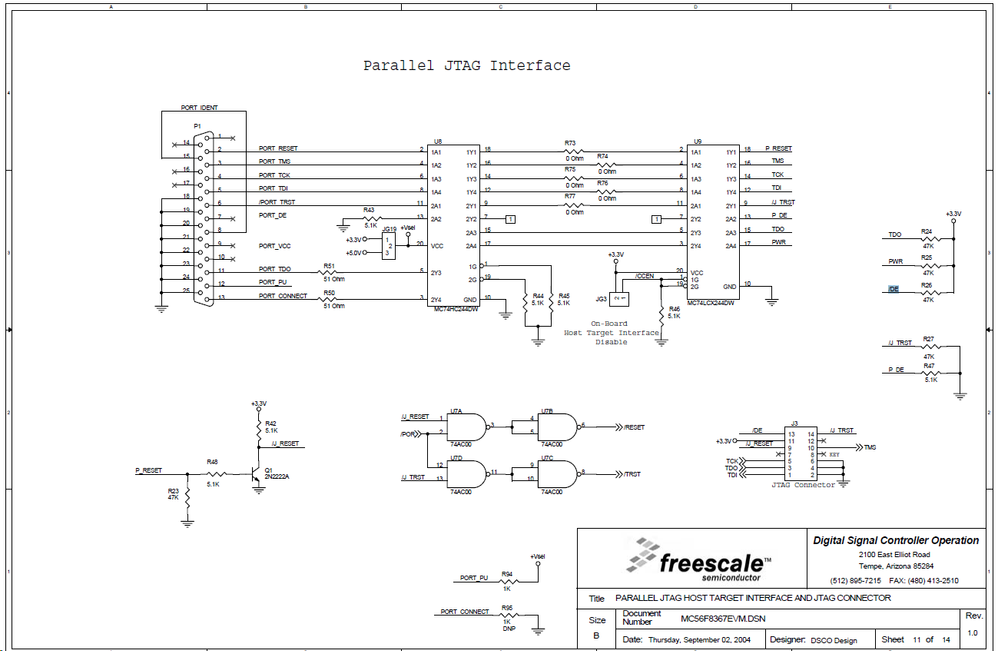

xiangjun_rong
Hi, Sasi,
I attach the JTAG part circuit from the MC56F8367EVM, you can remove the parallel circuit, but the pin assignment of J3 connector should be the same. Regarding the /DE pin, I suggest you float it rather than connecting to a pin. Furthermore, you should use the pull up/down resistor for the JTAG pin signals as the screenshot.
Hope it can help you
XiangJun Rong

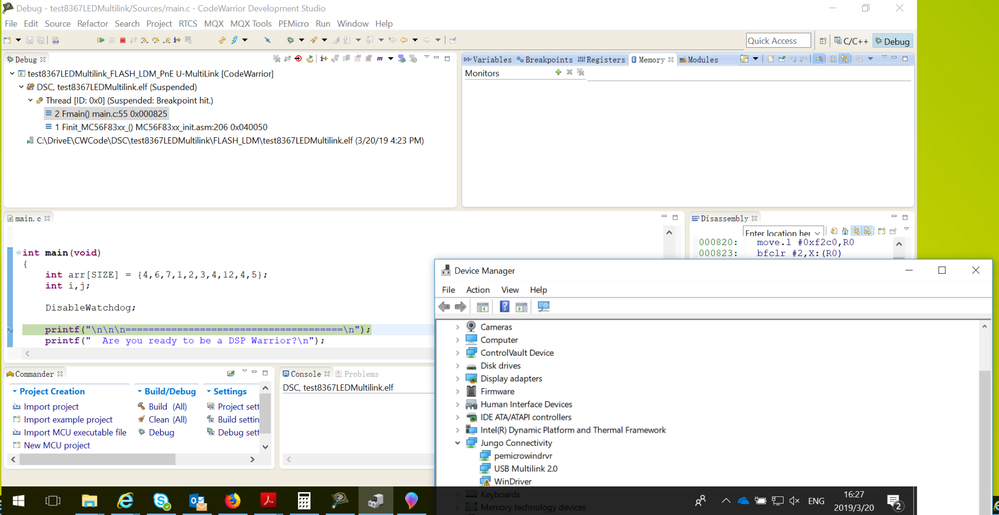

xiangjun_rong
Hi, Kumar,
I have tried to download/debug based on 56F8367EVM board and CW for mcu ver11, I can download code and debug with Multilink Universal device.
Pls see the screenshot:
Xiangjun Rong

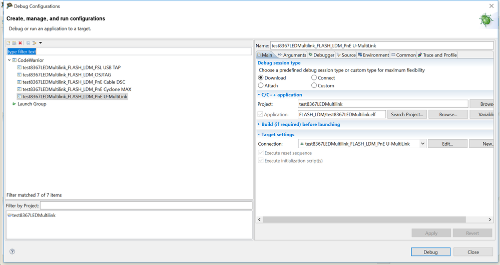

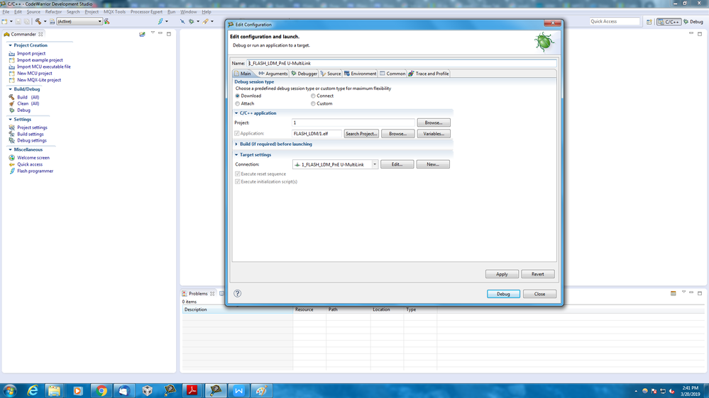

xiangjun_rong
This is the configuration of CW 11.
Xiangjun Rong

sasikumar_e
Thanks xiangjun
Could find only edit configuration,will try to pull up the TDO pin and Reset PIN, whereas we already tried to pull up the reset pin yet we could not solve the error and from some other forums we found the pull up resistor connected should be 47k; is it mandatory to connect 47k for pull up resistors

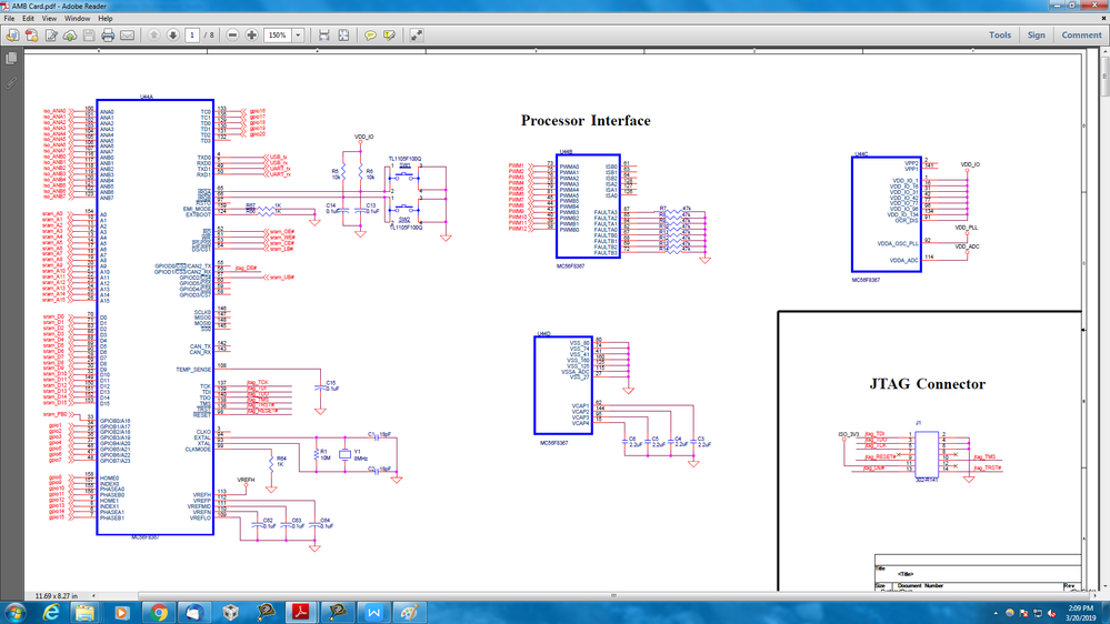

sasikumar_e
Thanks xiangjun
we are not working on a evm it is a custom board and could you clarify the other above comments
