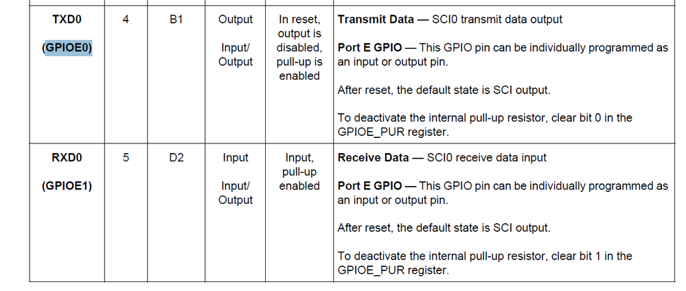

xiangjun_rong
Hi, Sasi,
I think you can write the code as following, especially, I recommend you use a forever loop so that you can test the Txd0 pin signal
void SendChar()
    SCI0_SCIDR = 0x0061;
    while(!(SCI0_SCISR&0x8000))  {}
   // Tx = SCI0_SCIDR;
void RecvChar()
  SCI0_SCISR = 0x0000;
  while(!(SCI0_SCISR&SCI0_SCISR_RDRF) ) {}
  chr = Tx;
void main(void)
    SIM_PCE    = 0x0010;
    GPIO_E_PER = 0x0003;
    GPIO_E_DDR = 0x0001;
    SCI0_SCIBR = 391;
    SCI0_SCICR = 0x000C;
for(;;)
    SendChar();
    //RecvChar();
Then test the TXD0 pin to check if there is signal.

xiangjun_rong
Hi, Sasi,
Regarding your question, for example, if you want to use SCI0, you have to configure the SCI0 pin as SCI0 pins because the pins are multiplexed.
GPIO_E_PER|=0x03; //1 = Pin is for peripheral (Normal mode)
//configure the baudrate of SCI0, it is dependent on the IPBUS clock
SCIBR=0xxxxx; //SCI Baud Rate = IPBus Clock/(16 × SBR)
SCICR=0x00AC; enable both transmitter and receiver and enable interrupt, SCI is 8N1(8 bits, one start and one stop mode, no parity mode)
IPR8|=0x0xC0; //set the priority of SCI transmitter INT
//open interrupt by clearing I0/I1 bits in SR reg
Cpu_EnableInt();
//asm(bfclr #$300, SR);
SCIDR='a';
for(;;)
void sci_int(void)
SCIDR='a';
In the vectors.c
 JSR  Cpu_Interrupt                   /* Interrupt no. 68 (Unused) - ivINT_SCI0_TxEmpty  */
to
 JSR  Fsci_int; Cpu_Interrupt                   /* Interrupt no. 68 (Unused) - ivINT_SCI0_TxEmpty  */
But I dot test the code, pls have a try.
XiangJun Rong

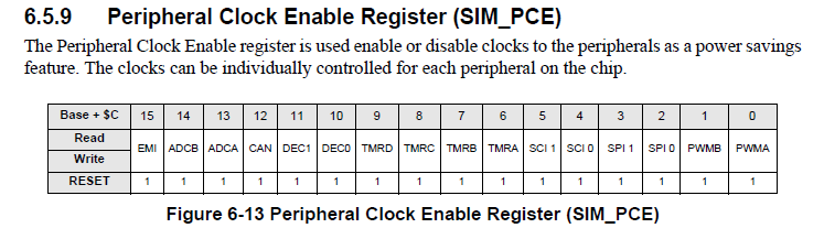

xiangjun_rong
Hi, Sasi,
I forgot that you have to set the gated clock bit of SCI0 module, pls set it as the following screenshot.
SIM_PCE|=0x10;
XiangJun Rong
10,428 Views
sasikumar_e
Thanks xiangjun,
i have tried that at first but there was no use, since from the reset the SIM_PCE is 1 so i neglected that line
sasikumar E
10,428 Views
