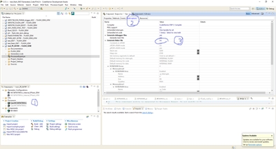

dear nxp expert,
FLASH_SDM.cmd file will be updated automatic when processor expert generate code, then the change in cmd file will lose. how can i disable the automatic updating of cmd file.

Hi, Terry,
Pls follow up the procedure on the screenshot to frozen the link file
Hope it can help you
