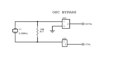

Pls refer to the fig for the external crystal connection without capacitor load.
I attach the user manual of DSP56F803-EVK, I copy the fig from the user manual of DSP56F803-EVK at page A-3.
Hope it can help you

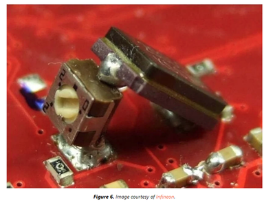

The info you provided me shows connectors in series with crystal and DSP on a development board, does not show driver circuit inside the DSP56F803. I need to know what the absolute negative resistance value (Rn) for DSP56F803? Need this value to select an alternative  8Mhz crystal oscillator with ESR=100, without load caps. Need to verify Rn is at least 500 ohms because the ESR need to be 1/5 of Rn.  Attached below shows a method to find Rn. Do you have any test data values for  Max ESR or Max Rn  you can recommend for the DSP56F803?
Rx needs to be an RF SMD type pot. and soldered in series very close to the  processor

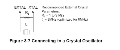

We are using the crystal in application shown below
