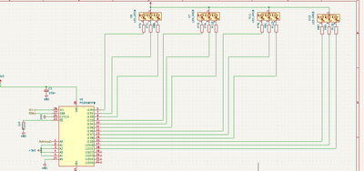

Dear Staff,
I have the attached schematic using PCA9685PW , and I need to switch on RGB leds individually.
I have sent the following  command succesfully in order to set the PCA9685PW internal register for open drain configuration
REGISTER: 0x01, ADDRESS: 0x10--->INVRT=1, OUTDRV=0
but I cant figure out how can i individually switch on and off the leds , something like  :
  1. switch on LED0
  2. switch on LED1
  3. switch on LED2
  4. delay
  5. switch off LED0
  6. switch off LED1
  7. switch off LED2
Can you please send the right i2C tranaction?
Thanks a lot.
Nicola

I tried what you suggest just for led 0 but nothing is happening. Following the commands I send and the device responses:
One think to consider, looking to the schematic , the LEDS power supply is not Vdd of the PCA9865 chip (3,3V) but its 5V...dont think this is an issue since I configure the GPIO like opendrain .
As you can see I correctly write LED0_ON_L=0x00 and LED0_ON_H=0x10 and i can even read the value back of the LED_ON_H back  and just written correctly: im sorry but nothing happens into my board.
Traces on the PCB seems to be ok infact when i give power to the board , all RED led are on (dont know whyhonestly) , but when i send the first command (INVRT=1), they goes all down.
Do you have some ideas? Is the schematic the issue?

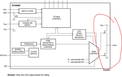

You can see its LEDn channel structure which is push pull. so the high output is about VDD and low output is about ground,that's why we recommend application circuit drive  MOSFET instead of directly drive LED.
In you case,you can pull up these LED into VDD and test again.

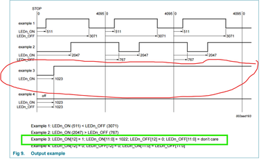

2: You can refer to below picture showed example3:
LEDn_ON[12] = 1; LEDn_ON[11:0] = 1022; LEDn_OFF[12] = 0; LEDn_OFF[11:0] = don’t care
LEDn_ON[12] bit=LEDn_ON_H[4]bit
