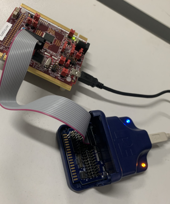

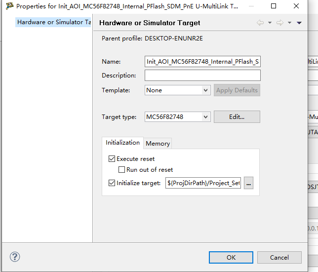

用codewarrior连接不上pemicro   电脑识别到pemicro使用的开发板是TWR-56f8200程序烧写不了

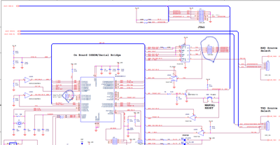

Hi, YuYu,
You use TWR-56F8200 and Multilink Universal device to download code, in the case, you have to do as the following procedures:
1)Open J20 jumper
2)open all jumper on J21
Pls have a try.
Hope it can help you
